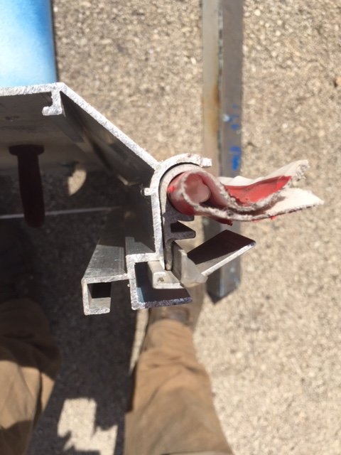

They aren't Signcomp. They are, I believe, ABC Sign Products they look like this.

Thanks a ton. I think the main thing I wanted to know is whether or not I should install the clips before we get on site. Which I will do.
