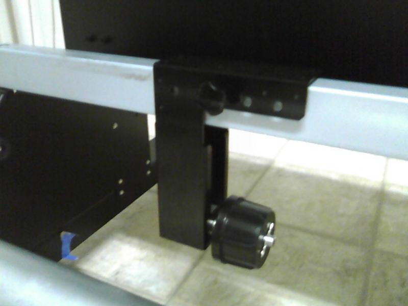

reel pic
I havent see the Mutoh take up, but what causes it on my roland is that the right side where the take up motor is, is solid and stationary, while the adjustable side is this flimsy bracket that no matter how tight you make the bolt, it will still move. Especially while you are trying to tape the media to it. Here is a pic to show the weak bracket.

ucmj22
I wish I could attribute the fault to myself, trust me I've tried; however, it doesn't matter how I tape it if the left side of the take up reel is able to rock back and forth while i'm taping it. I thought I had it somewhat under control by jamming a piece of coroplast between the bracket and the rail, but that only works for a couple of days or so before the coroplast is too flattened to keep the bracket from wobbling. but it sounds like this is a me issue since no one else is really having it. thanks for the help.
ucmj22
thats what is happening here. When I see the slack on one side or the other before going over the dancer roller, I know its time to step in and and jerk with it to get it straight. usually by pushing or pulling the bottom of the 'left side bracket' forward or to the rear it will start going straight. I am certain however that if I call roland tech they will tell me I taped it wrong. I get it, if I was them, I wouldn't say "yeah we put a 50 cent bracket on there and dont plan on fixing it soooo just tape it seven ways from sunday till it goes straight." We do alot of concession trailer wraps so we do a lot of long runs and this has been a constant issue. It cost us a ton of money when we did a huge banner order for the KY Derby and I left it printing after I left at night. take up went crooked and the head was hitting where the bulges were created putting diagonal lines across 4 10ft pantone matched, high density banners. I no longer leave it unattended.
Mainframe
If sticking a piece of coroplast in between a bracket will temporarily solve your problem, then you have you have in fact diagnosed the problem & figured out a repair. Why don't you use a more substantial shim, like a piece of lexan or even a piece of aluminum, I would also suggest a couple of strategically placed drill screws for a more permanent repair.

ucmj22
well, I tried a piece of signabond lite, and it was just a hair too thick to slide in to the gap. my only other option would be to get some synthetic door shims and use those. The only problem with this shimming fix is that the shims fall out, and have to be put back in to place every time I put a roll on or off. I guess I was hoping someone had a genius fix that they discovered. What irritates me more than anything is that I have to jam a 10 cent shim in to a $30k machine for it to work properly, but i guess im just ranting now, so thanks for the help.
