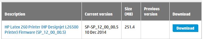

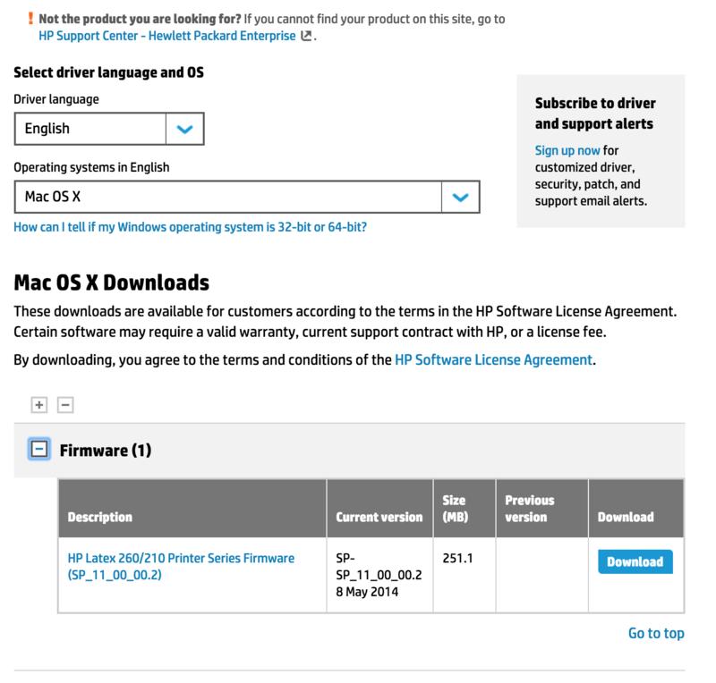

With the HP Latex machines, printhead longevity is affected by many variables and it is important that everything be set-up properly in order to maximize usage from thermal printheads. First, be sure to upgrade the printer firmware to the current version. As of today, that is SP_12.0.0.5 for the Latex 260.
I just checked my printers firmware and it says its up to date at SP_11_00_00.2 is that right?
