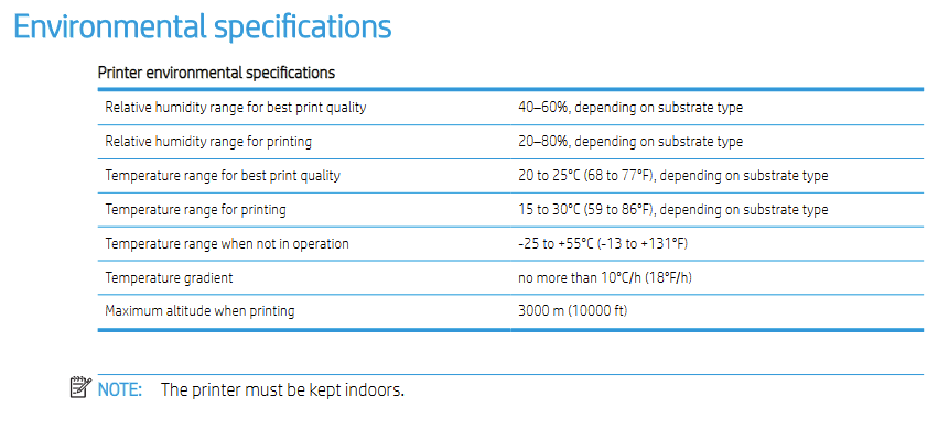

I have my eye on a used HP 330. It looks to be in fantastic condition with low hours. The asking price is decent at 4k CDN. Only issue is that I would need to store it in my garage for a number of months until I can put it to use.
I’m wondering a few things.
1. Would it be ok to store the printer in my garage where it can dip as low as -10 yay Canada) without damaging the printer? What temps are safe for storage?
2. Are there things I should be doing while the printer is in storage regardless of the temperature? Ex. Running off a small print every few weeks?
3. Lastly I am wondering if I could get some advice on some simple things I can do to test the printer before purchase beyond a test plot? I have extensive experience running a few different hp latex printers over the last 4 years but haven’t had to do much in the way of troubleshooting issues.

I would take ink cartridges and printheads out, store them away until you are actually going to use it.
Then you might as well install all new ink cartridges and printheads. So testprints... don't even bother. Error log is more useful.

Is there a way to purge the inklines before/when you remove the printheads and ink cartridges? That would be really best.

-10 doesn't sound good... I had to empty a R1000 for shipment. There is a procedure and a device you can borrow from HP. When the ink freezes in the tubing, it will destroy things
I'm not aware, that something similar exists for the small printers.

Yeah one could do the flush on the lines with the same machine but at that point it's almost better not to buy the unit just to store it for unknown time. Might as well buy one later when you need it.
Gen4 ink is different but HP says gen3 is fine to move below 0C with inked lines.
