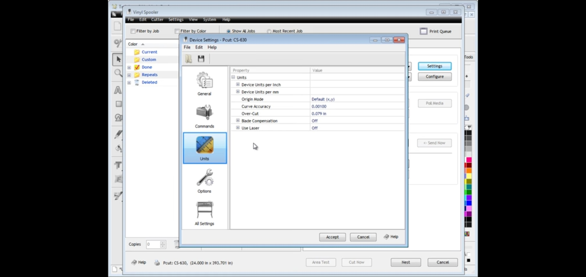

have you been in here to settings for cutter?...looks like you need to adjust force and overcut or similar
Yes, I've been there a number of times in the past, but had given up on it getting better. I will revisit the settings again. Just wanted some professional input first. Thank you
Amos_McFly
Update... I revisited the settings and did a calibration, which I've done a dozen or so times before. This time it worked well and as far as I can tell, there are no more off-cuts.
Thank you!
