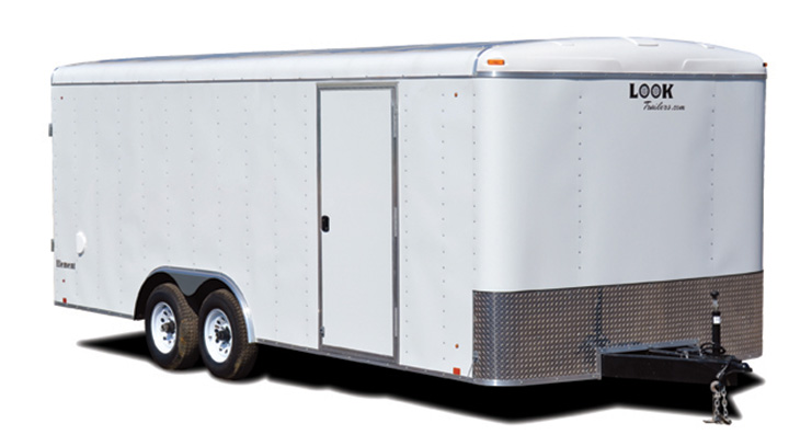

Changing the color of this trailer from white to Red.
Size is 24' x 8' wide. I think the height is 7ft.
1) What vinyl would you suggest?
2) Would you pull the rivets?
3) How about the roof......Would it be feasible to paint the roof vs using vinyl?
Anything to watch out for on these "Look" trailers? (I never heard of them before, to be honest).

oops. A picture may help.
ps. notice domed roof.

Cast air egress red film from manufacturer you prefer.
If it's rivets wrap over top, it's probably screws, some folks prefer to wrap over top and some pull. Normally I pull them but on this project you would either have to paint them red or leave them white.
Painting the the roof could be done. It's probably more dependent on the expertise of the painter to match the vinyl color.

We use 3M 180 series solid color vinyls and 1080 series solid color vinyls for color change wraps on trailers all the time here. We also remove all of the screws as we go.
I would say just wrap up to the "gutter" line and stop there, that should look good - or else you're gonna have to wrap a couple feet up all the way around.

Seriously, if riveted, 3M 1080 Red vinyl is the stuff. I haven't seen a trailer with screwed on panels in years. All rivets around here. Not an issue with this vinyl.

Wrap it like you would any other vehicle. Leave the rivets in. I could do that alone in about 5 hrs. EZPZ
I could take the screws out.......have 2 other people to help...... and it would still take me 10 hours to wrap (one side) :Big Laugh

The boss is going to wrap it. She is going to remove the screws (it is indeed screws), and paint them. I think that will be a nicer job. She was leaning towards Avery SW900 film. I'll let you know how long it takes her (and her helper). I'll make myself scarce for the day.
