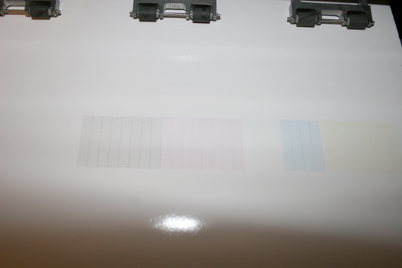

tried to put printer into service mode to enter new head id by holding function and remote keys while printer was booting. The "input head #" screen never came up, the printer just started as normal to the "roll-sheet" screen.

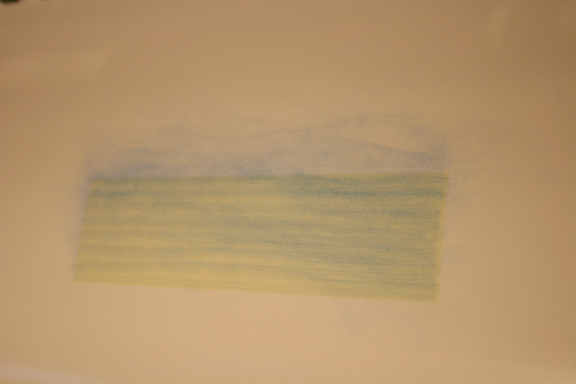

Did a test print, m y and k printed fine as in attached photo, cyan only printed 1 side. I used syringe to pull ink through head, swapped damper, and ran clean cycle, still only 1 side of test print. Then created a cyan rectangle in flexi to test print. Cyan head printed a cloudy print even outside rectangle. Other attached file.

You either have a damaged head (either by inserting the flush too hard or received that way) or the slider/main board is damaged (in which case you need to get that repaired or replaced.
