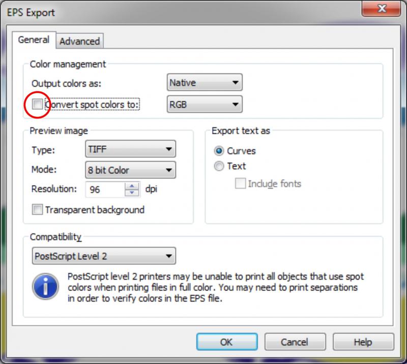

More than likely you have your "Convert spot colors to:" checked in your export dialog.
Make sure it's NOT checked.
