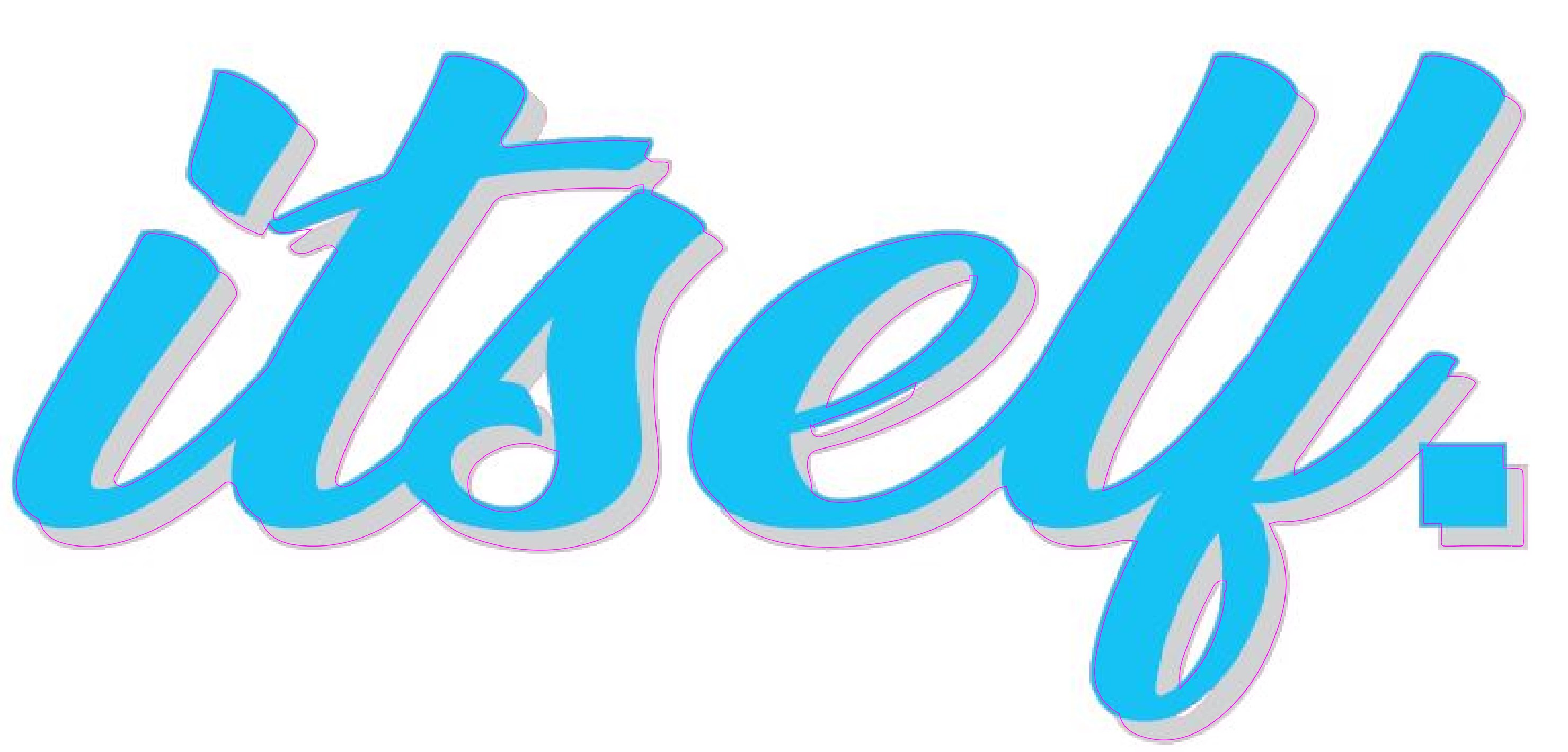

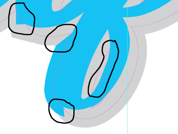

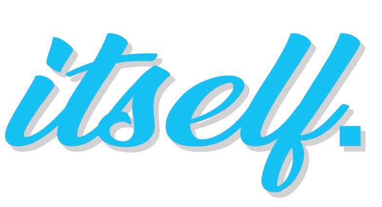

Here are pics of what I am speaking about. the one labeled "ISSUE without BLEED" shows what should look like once cut. Image labeled Issue with BLEED shows how I have to add extra triangle or shapes to basically halve the two colors where they touch. Image labeled Full word shows the two color word in the image.

I just negative offset the cut line a bit, never noticed a problem this way. -.05" or so depending on the size of the design

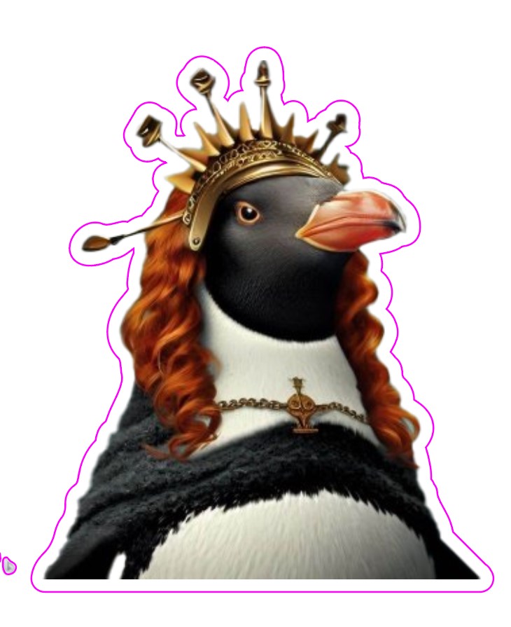

How would you create a small sticker that has a white outline without using offset path?
offset path is a tool I use on just about every job
you are now off topic to the op... but what you are showing... how would I do that?
On the exact trace cutpath, I'd Create an outer stroke set to "x" measurement, and then expand the path, delete the inner part, and there is my "offset " cutpath. Probably smooth out, simplify, the path as well. Perhaps this is the long way... I'm always up for learning a better way...

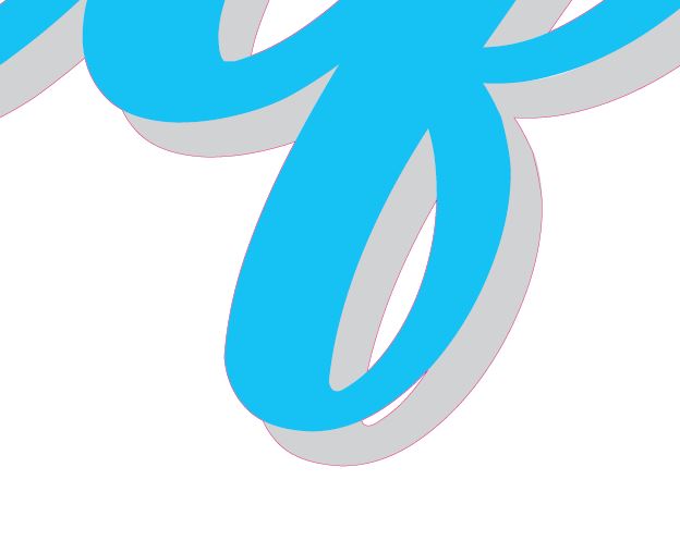

I think negative offset path is hard to beat. This example was made from a pretty bad original cutpath so would be better if made from a good original cutpath

I cut full rolls with this amount of bleed on my Graphtec, some of the designs are 10ft. Cuts pretty much dead on the entire roll as long as I use the flange system.
You could throw a positive offset bleed behind this for added peace of mind too
