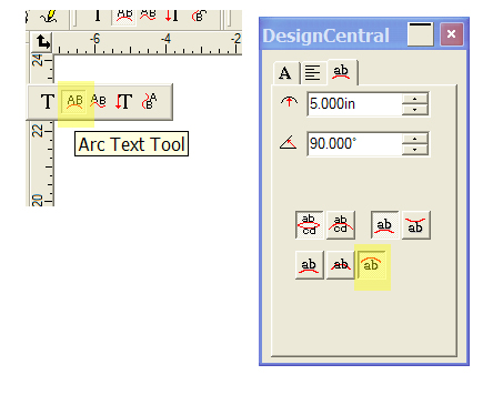

Please help.
I need text inside a border, following an oval shape.
I've tried the line type tool but it is send the text upside down to the opposite corner.
Thanks for the help.
-David

Try this
Hope it helps
