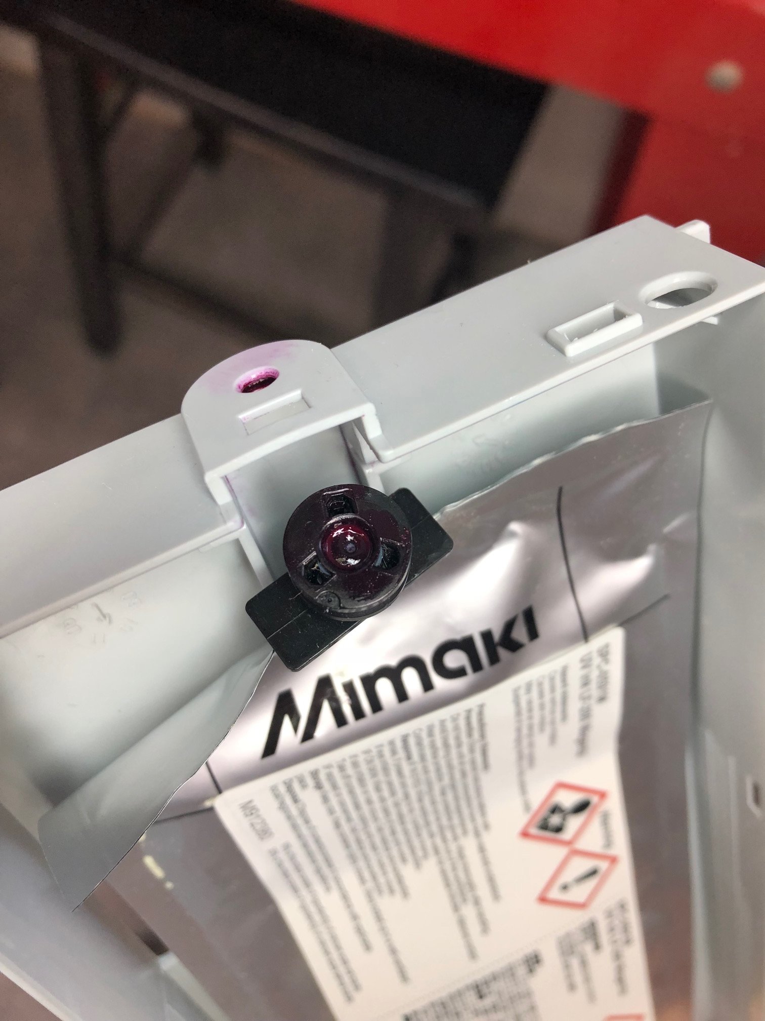

I have a Mimaki UJF 3042HG that has been printing fine then a few days ago the test print showed almost no magenta (a few intermittent nozzles are printing). I replaced the damper and cap and cleaned the needle to the magenta. There is plenty of ink left so that is not the problem. I did the ink route leak confirmation procedure in the Maintenance Manual and found no leaks. When I do an air purge I am getting bubbles in the magenta. The line to the magenta damper appears to be sound. I checked the ribbons and seated them on the board. Is the O ring not sealing? Is the pump acting up or is it something else? I need to get this machine printing as I have a few orders to fill and am stuck in the water. Thank you for taking the time to help!
