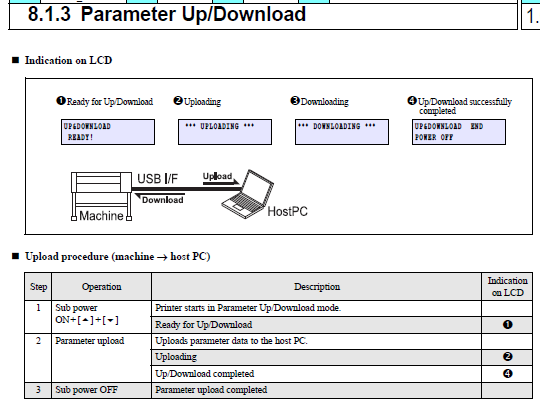

Hi,
I've read on the internet that parameters can be uploaded/downloaded to the machine.
How would I obtain factory parameter settings? How would I go about installing it to the machine?
Thanks

Send an e-mail to mimakiservice@mimakiusa.com. You will need to provide your serial number.
DankBoiDex
Thanks a lot for the information.
I have followed the instructions and successfully uploaded and downloaded the parameters to and from the machine. Once I upgrade the firmware, I will use this method to edit and adjust the parameters accordingly.
