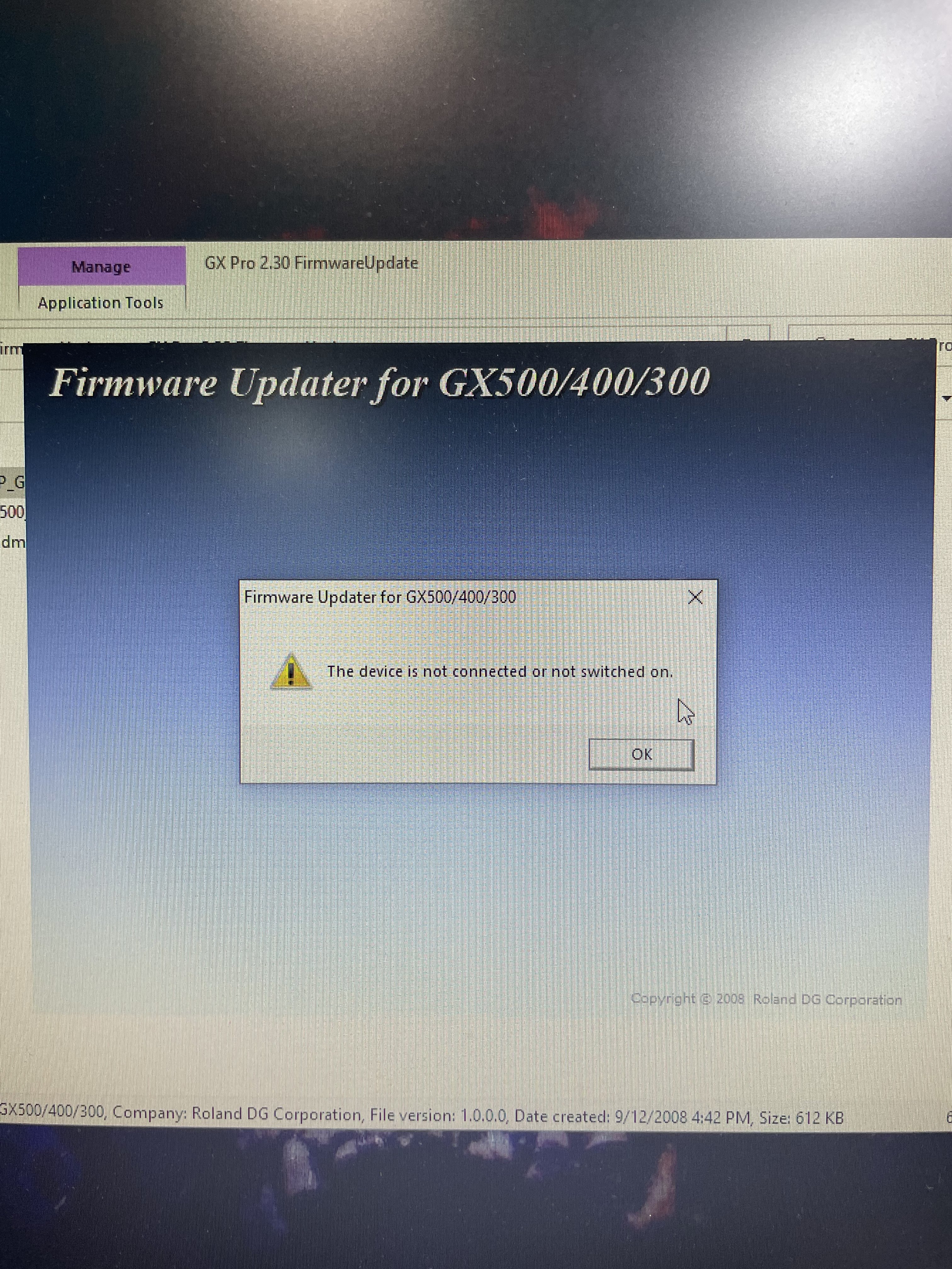

Sorry to dig up a old thread but I just tried to update the firmware on my gx-500 and keep getting this error even though it’s turned on and plugged in
