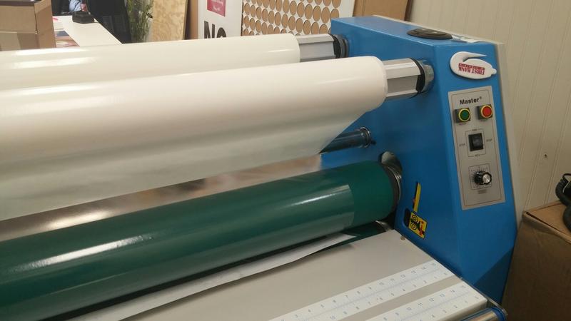

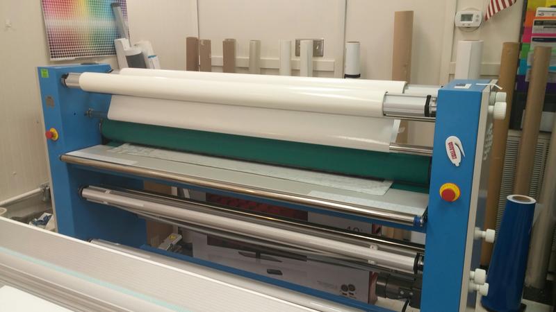

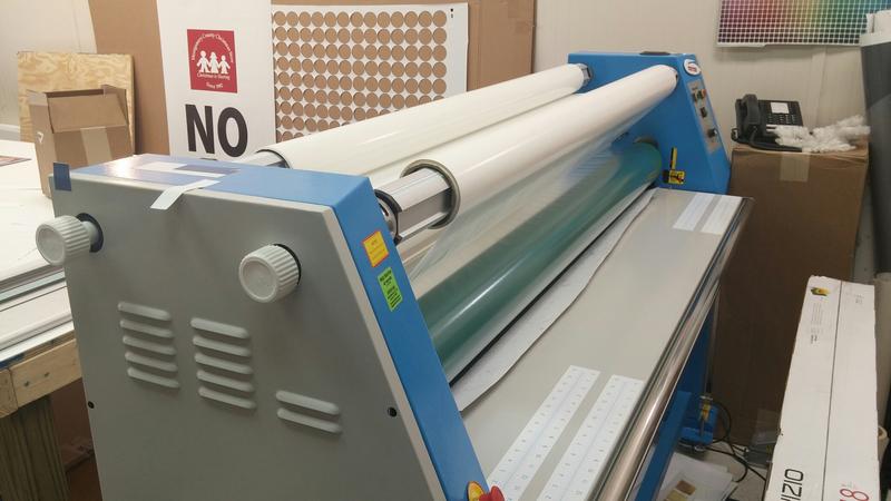

Picture please

Great machine, great value...
I mainly laminate everything using cores. I will unroll the core and roll it up again to help do long runs. When the prints on the core are nice and level on the edges it will barely even go off after Many Feet.
