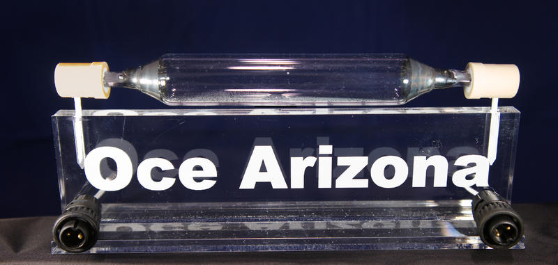

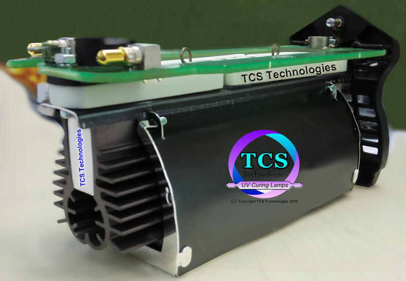

To make an accurate diagnosis we need the model of your printer. Fuji uses two different style UV lamps in their printers. One system is cassette style--see attached picture
attachment.php
Newer Fuji machines use a lamp having black connectors attached--see picture
attachment.php
Each lamp style has its own merits. The cassette style is know for shutter issues and that would explain shut-off mid print. It also has machine voltage issues which might occur in the summer. The lamp with black connectors is powered by a higher quality UV power supply however shutter sticking can always be an issue. After knowing what lamp you have we can move forward toward a solution
