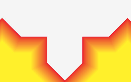

I occasionally run into a graphic that is provide to us with a vector gradient
or shadow I have attached a sample that doesn't show this very well- but
when clicked on it will display maybe 50 different color variations to make up
the gradient. I assume it is done in AI? My versions CS2 & CS5 a drop shadow
is a raster- is this effect from an earlier version? Thanks Gene

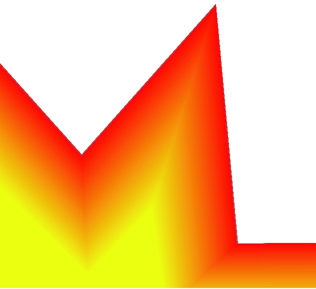

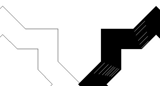

Yes, this was done in ai and its just a blend. Start with a filled shape, offset the path and fill with yellow, choose a point on each shape with the blend tool, and choose the blending steps. easy stuff. It is in all versions of CS.
rjpjr
Agree... If you are seeing MANY vector shapes to create the gradient, the blend has just been expanded.
