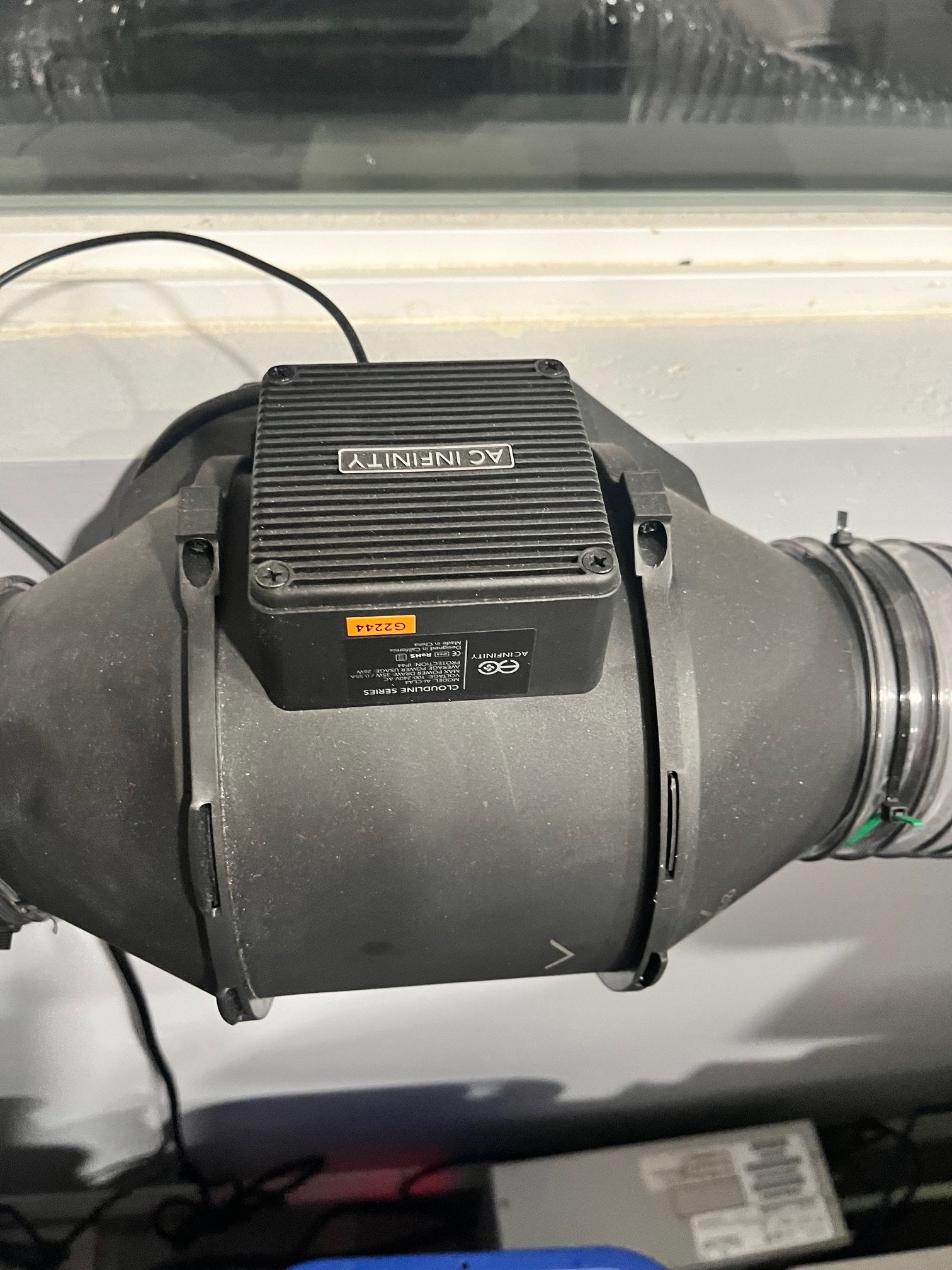

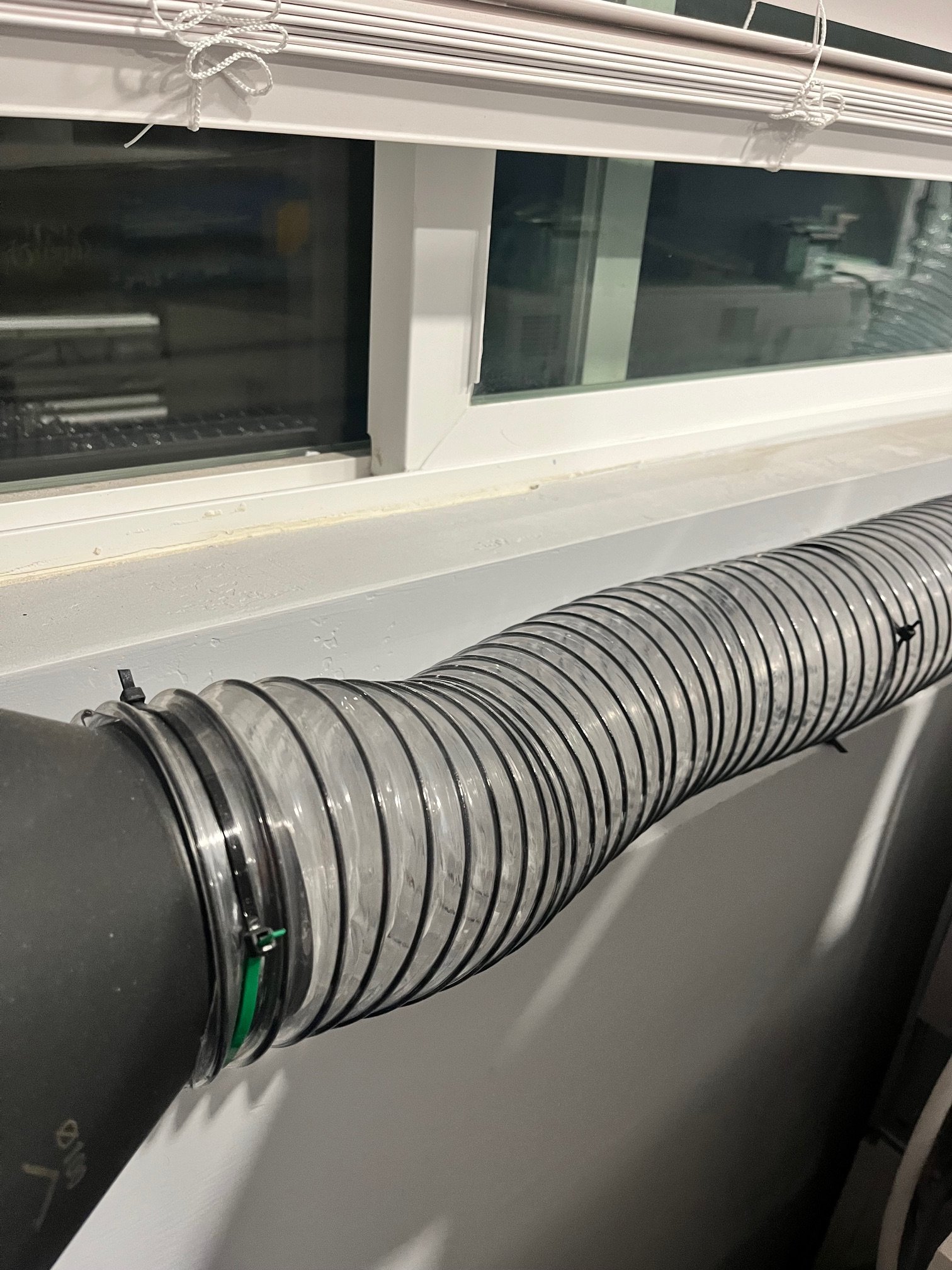

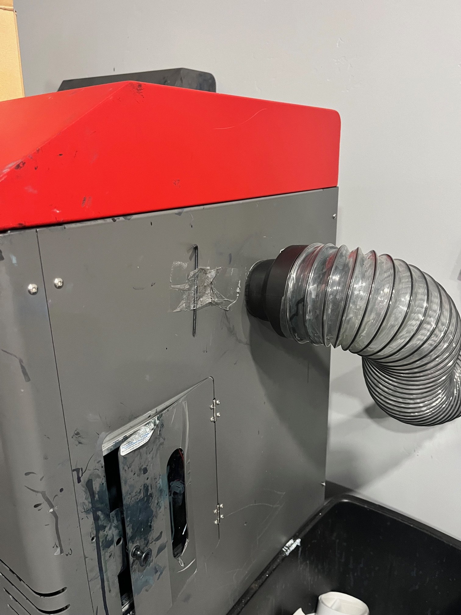

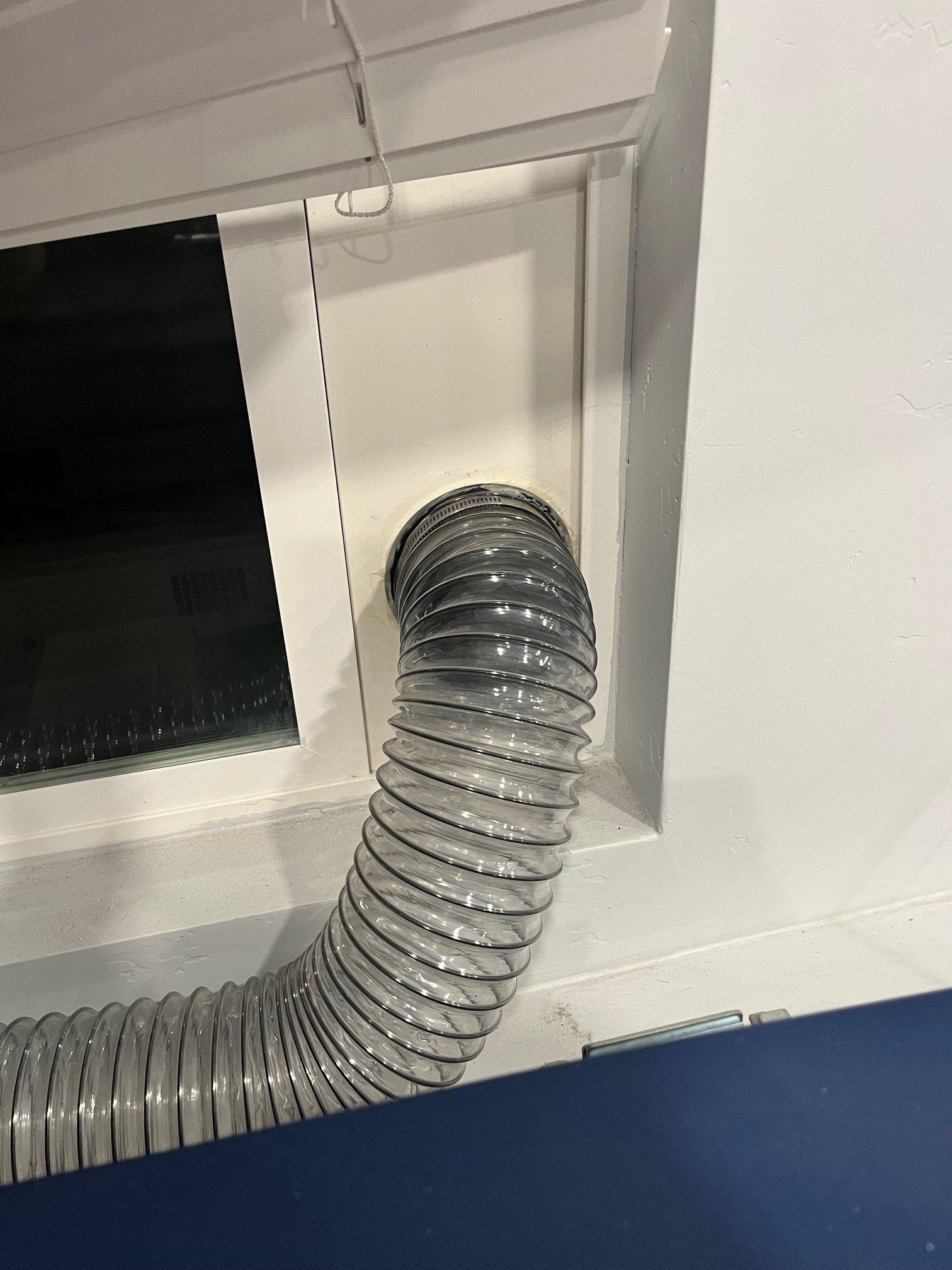

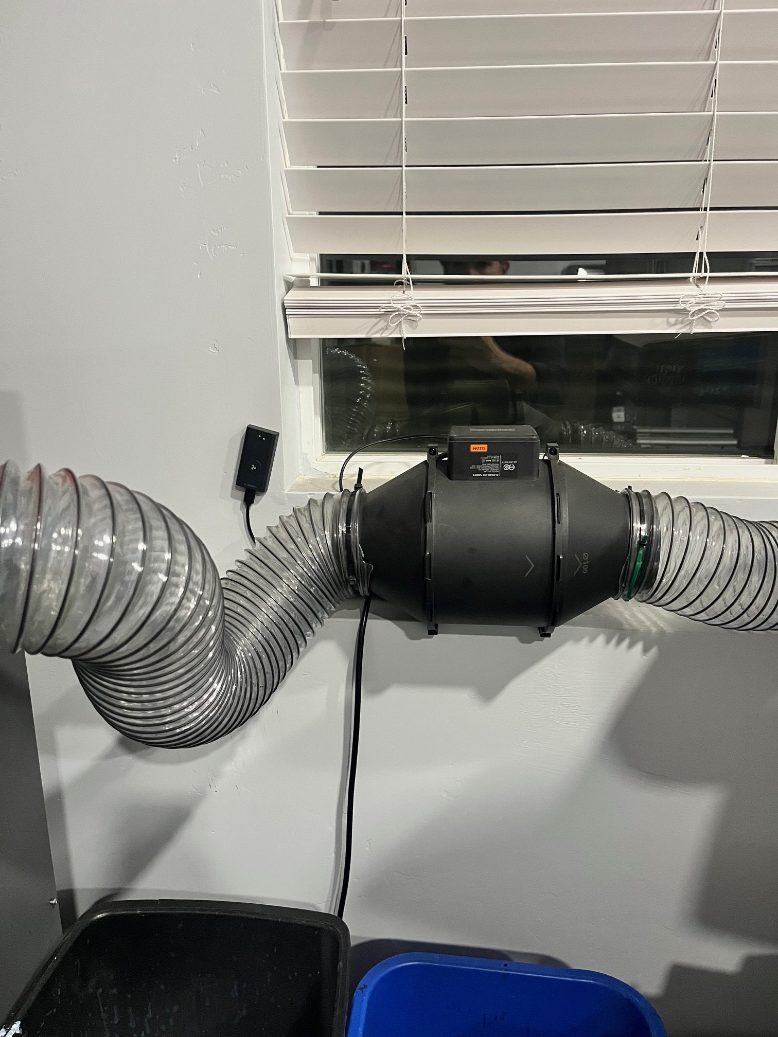

psljuan
I bought an inline fan and hoses, I had to cut a hole onto the side of my machine (compress UV600) , then ran them all to a window, and that takes care of the smell. I spent less than $200 for all of it on amazon, I'll attach pictures

johnnysigns
I love those inline fans! We use something similar on our laser and they're super quiet, but they flow pretty well.
Signstein
I can also vouch for those AC Infinity cloudline fans - they work incredibly well! I've had one running for a few years straight without issue.
