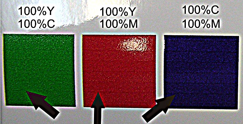

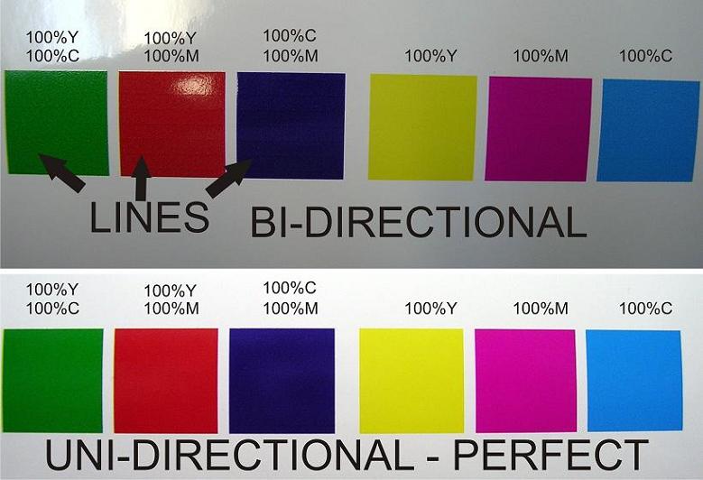

Please take a look at this pic.
VP-540
max inks
40/45 temps.
VersaWorks
Standard 720x720 (v) mode (8 pass)
+.05 feed calibration
head speed = 720mm/s
feed speed = 8mm/s
Uni-directional print is perfect.
I can't seem to get my settings dialed in for perfect bi-directional printing of SOLID colors. I've got my bi-directional calibrations (simple and detail) properly adjusted. Any suggestions? I hope this isn't something I'll need to live with. I'm picky and I've got a little case of OCD. :smile:
:thankyou:

its easier to see in a larger image but we're limited to 800px here.
I'll email a larger version to the address on your website.

I'm running versaworks unidirectional on all my prints that are going to be viewed up close. But I will print bidirectional when the viewing distance warrants. My bidirectional has some banding through versaworks but not quite as badly as that last pic.
Wish I could help but I seem to have the same problem. I figured it was the nature of the beast.
Graphics2u
Isn't there a way to adjust the step adjustment on the printer through Versaworks? Maybe in bi-dir you need to bump it up a little.
B Snyder
Yes, but there is only one "feed calibration" adjustment. There aren't separate adjustments for each printing direction.
