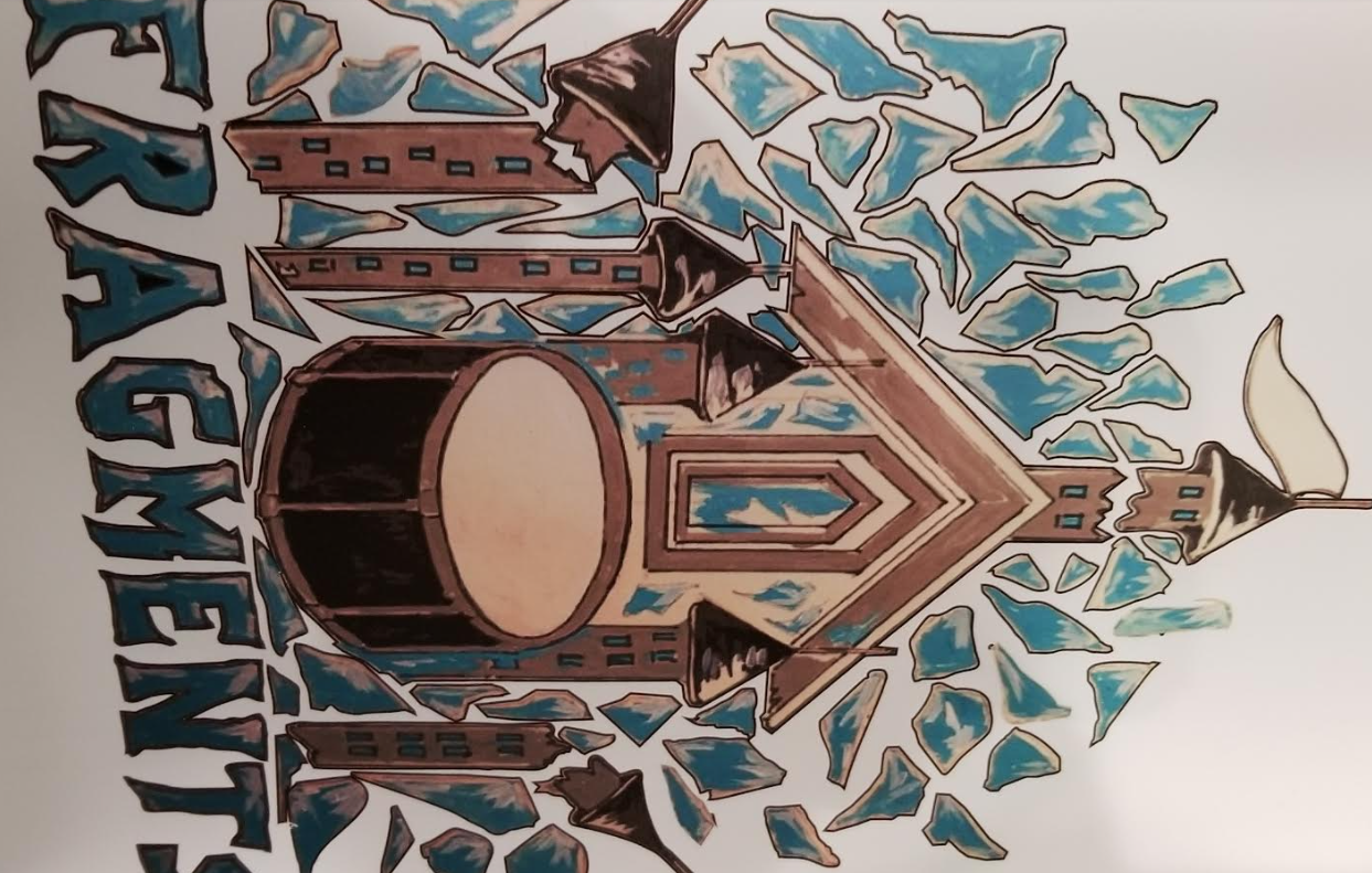

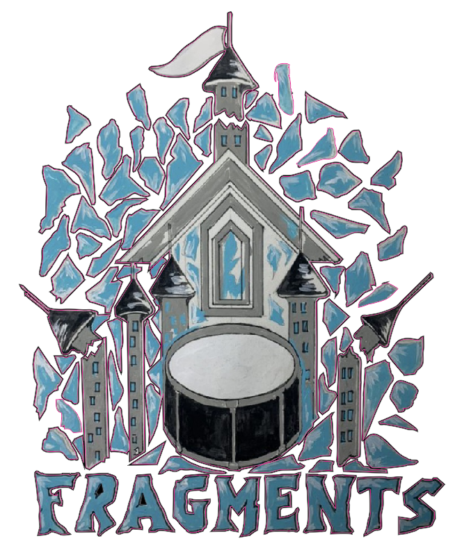

I have a supplied image that is a jpg which is fine. It has a lot of grey in it and it is printing tan or brownish. What adjustments can I make for this?
binki
VS-300, Textile Heat Transfer, 6 color ink with double white (no white ink)
The image is a hand drawing scanned in. The pink lines are the cut lines

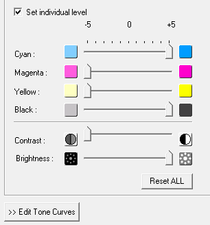

I have a VS-300i and it is notorious for putting in way too much magenta, which I would say is what yours is doing in this case. I would go into the color adjustment screen in versaworks and take out a bit of magenta (3 or 4 notches), maybe add a little cyan (1 or 2 notches).
binki
Here is where I am at right now. It is a little better but not quite, I am working on the image now to see if I can make some adjustments.

I might increase the contrast a bit, but you can also adjust the tone curves for the colors as well. I find it gives greater variations if the slider isn't enough.
binki
Thanks for the help. I was able to move the brightness to the left all the way and with the other changes it is really close. I just don't understand when I print on my desktop printer it looks good and the versacamm doesn't even look like the same image.

I was finally able to get it close enough by pulling magenta and yellow down, black up, left cyan alone, leaving contrast and brightness alone and using a profile that didn't put as much ink down and selected the fast print to cut more ink out.
