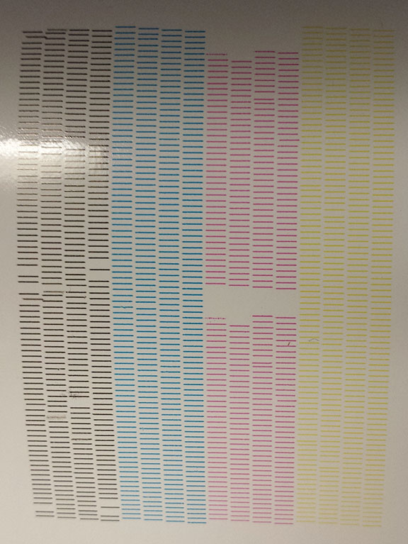

I just had to replace a magenta cartridge after I did, it started printing yellow.
I called Roland and this is what the tech told me (seriously) do 8-10 powerful cleans.
I told him this happened a few years back and I remember doing something with a syringe to get air out of the line but I did not remember exactly what I did.
He said do not do that, do the powerful cleans, so I did, about 6-8 of them and I after a whole lot of ink wasted, I am in much better shape.
When the problem first started the magenta hardly registered anything on the test print, but between the powerful cleans and printing about 5 square feet of pure magenta I got it to where it is now (see pic)
My prints have some banding so I can get away with a few small/cheap jobs, but nothing that will look exactly right.
Any advice where to go from here?
My thoughts are
1. I need to do that syringe thing, but I have no idea what I did last time.
2. Replace capping station?
3. Your suggestion???
