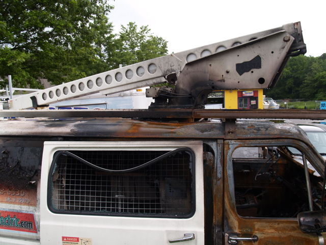

See this? That's what a burst hydraulic hose will do. From standing still to fully involved in less than 3 minutes. Truck was a total waste, only the generator and bucket made it. Fire co put a full truck of foam on it. Hot hydraulic fluid burns like crazy. Dont F around.

Wow Rick. I remember you told me about that but I never saw the pic. Your guy is lucky he got away from that.
My welder guy used to work for JLG, testing new lifts off the production line. He said they had an engine fire once and he got stuck up in the basket at 40' while the other guys emptied several extenguishers on it down below.
