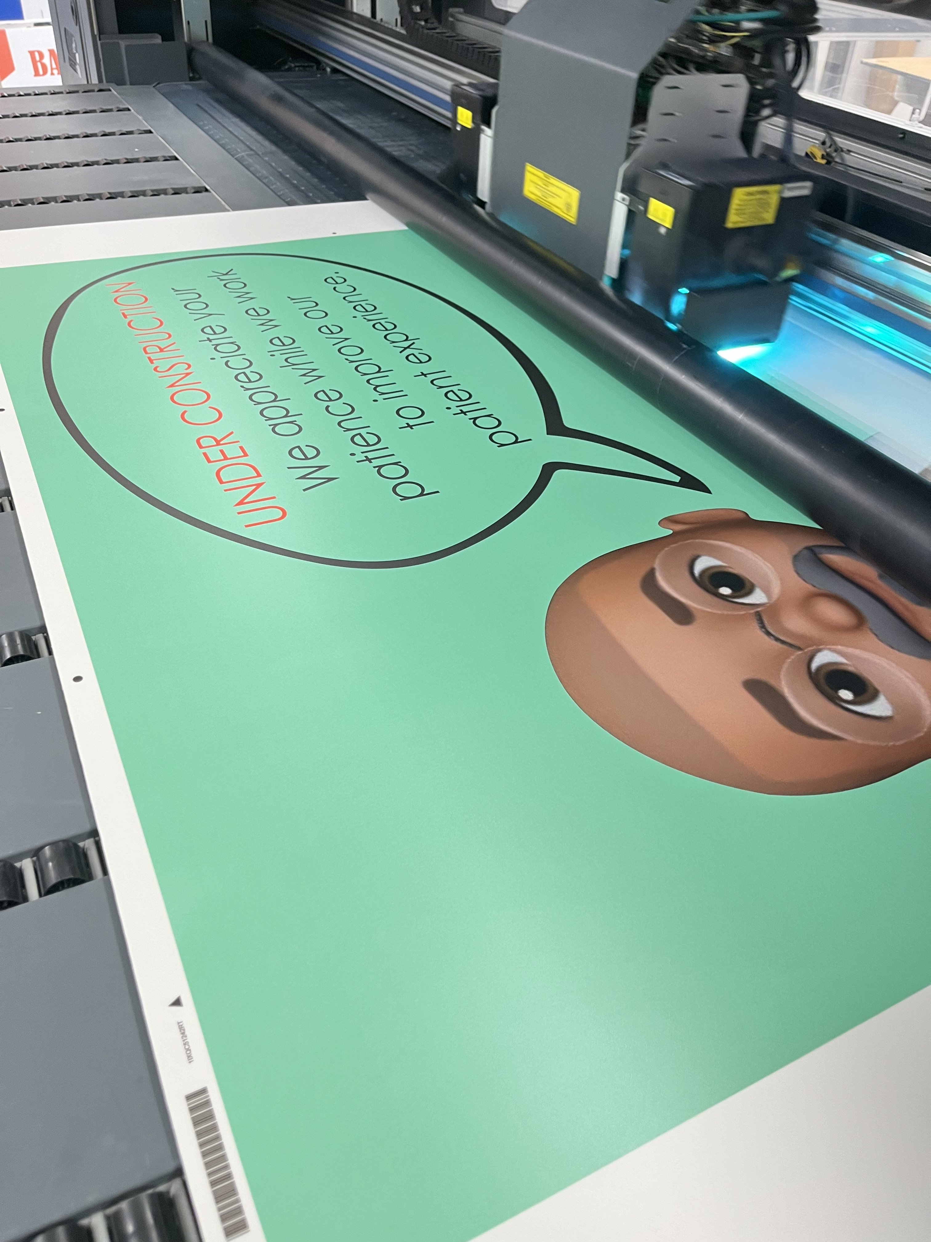

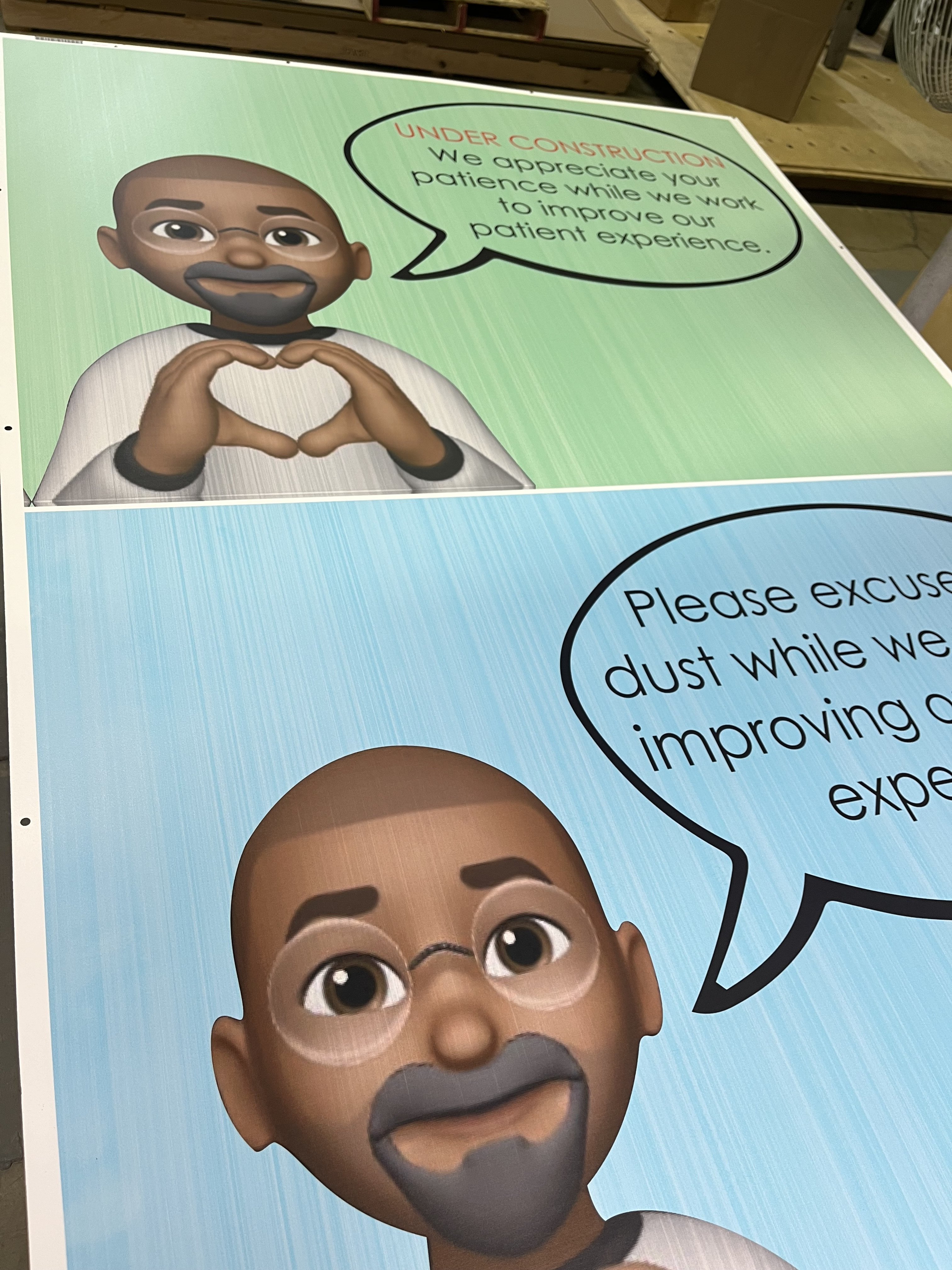

I am at my wits end here so finally going to post and see if anyone has input. We are getting strange vertical lines in our prints with FB700. I have tried everything possible to remedy. Cleaned carriage rail, cleaned encoder, printed prime bars and jet tests (all look clean). Printing indoor signage on 3mm PVC (which we print all the time). IMG_2354.jpeg The strange thing is the solid colors are all printing fine, see text in attached photo. We ran a bunch of old jobs with solid colors and they print fine. It seems to be happening on light colors only. We have run only CMYKW on this machine for over 7 years and never had this happen on light colors before. Any ideas?

IMG_2373.jpeg Well I know this conversation has pretty much been with myself but we found it was definitely the material. Went out and bought some new sheets from a different supplier and this is the result we got. Hopefully the conversation with myself saves someone down the road from wasting 5 days and a bunch of material trying to figure out this issue.
