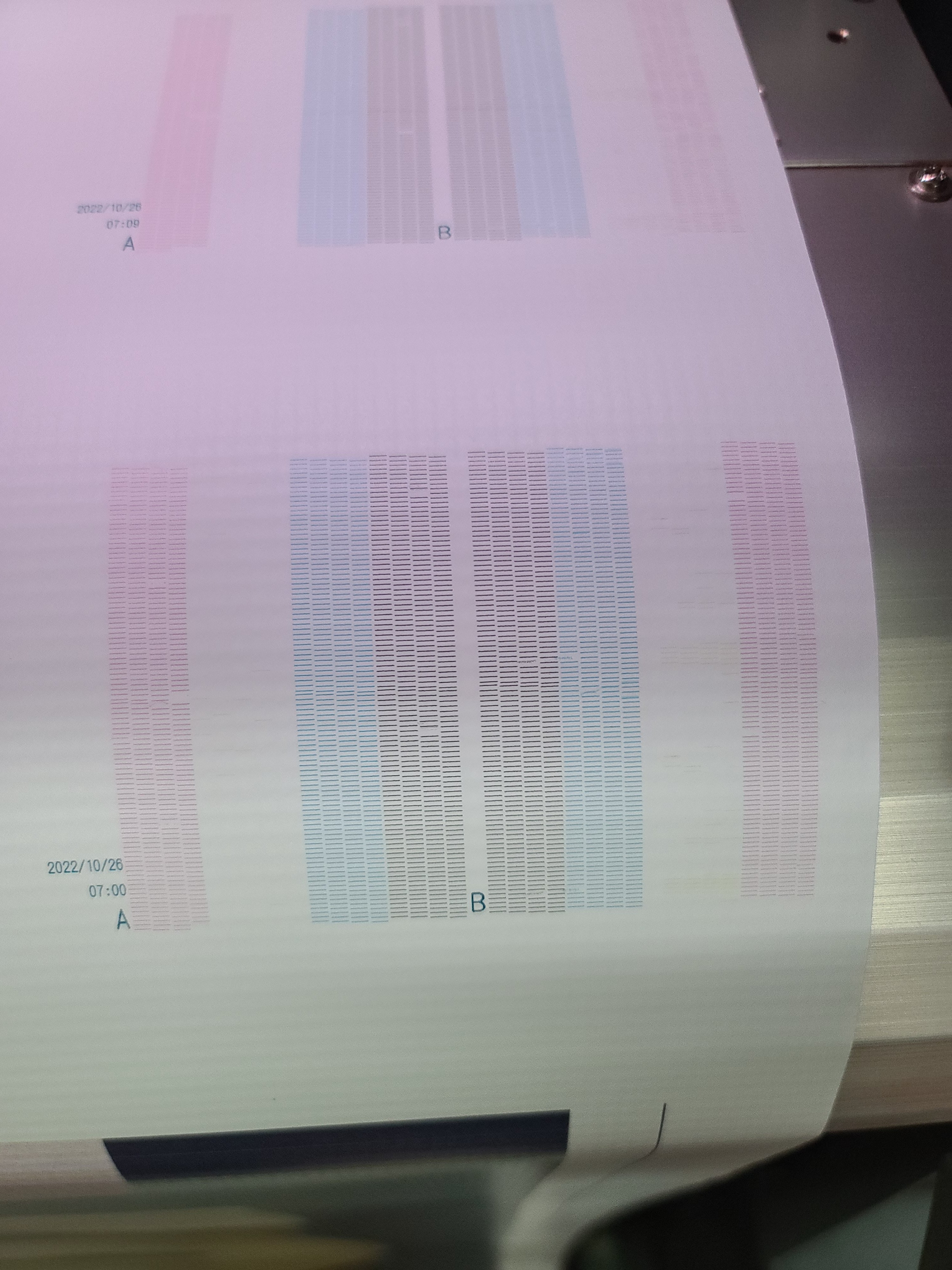

Any ideas what would cause yellow on both print heads to suddenly stop?
They work for a few feet after a cleaning then stop again.
Pump is fine when i can see it moving the dampers.
captops installed about 2 months ago. TR2 Inks
tim99
pulled ink though the captop. and issue seems to have gone away. i was able to print a 4x8 banner with heavy yellow usage without any issues. Still no idea what caused it but issue resolved for the time being.
