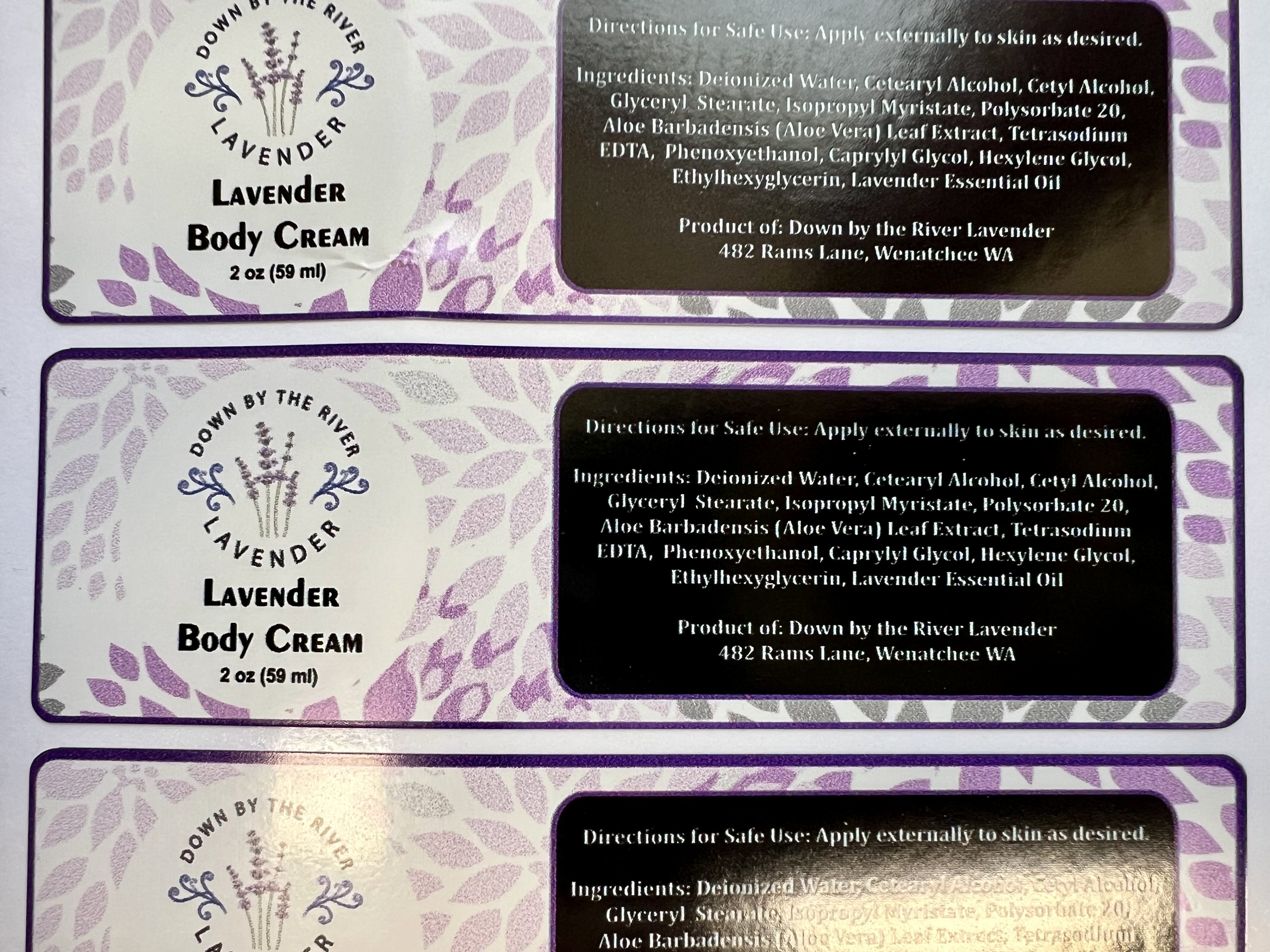

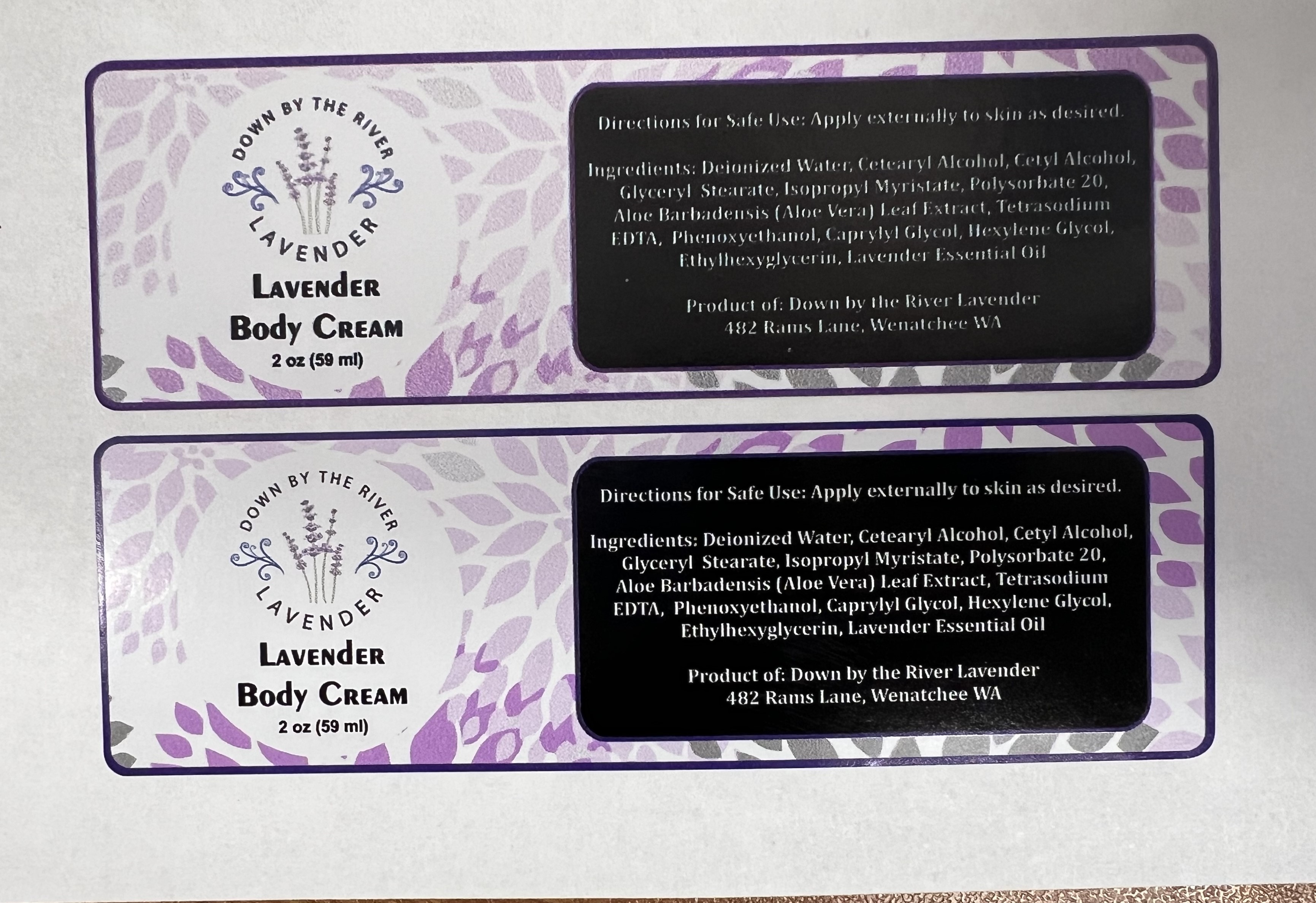

I've just recently upgraded from a BN-20 to a TrueVis VG3-540. To preface, I've been using the BN-20 for 10 years and am very familiar with Roland, Versaworks and how the print profiles work. However, I am so disappointed with the color quality of the VG3, and can't figure out how to fix it. The majority of my products are pretty small, so I can't afford to just look past it. Ive tried adjusting print quality, speed, bi-directional versus single, all the different profiles, and cleaning the machine. I have attached photos of the print on my BN-20 vs VG3. I cannot sell these decals to my previous customers with lower quality prints. The only exception is the black is always super dark, so I am confident its not a print head issue. Any suggestions to get it looking better? I'm really trying to like this machine.

We run the VG3 and I can say that that’s very much not VG3 quality. Get with your rep and see if they can figure it out. Try different profiles, but you’ve got something going on.

Thank you for the feedback, I'm glad I'm not crazy to think this isn't acceptable. I have had the rep out here several times, and he seems to think everything is calibrated and set up correctly. While he was here, we tried pretty much every profile and had the same results. Yes, I've tried several different media types and still get the same result as well.

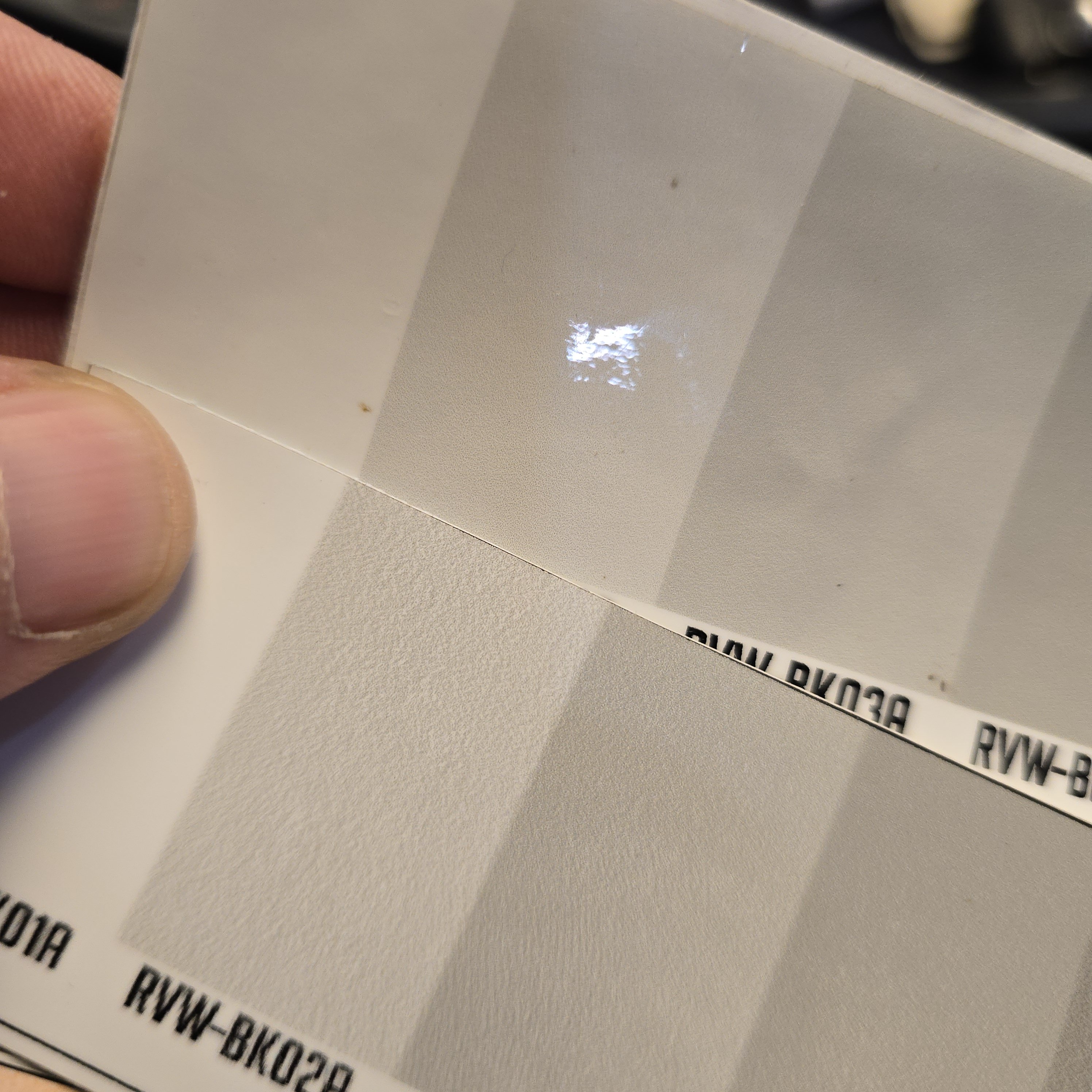

I had trouble when I first got my VG3, as the black on its Generic Vinyl 2 profile was not very black no matter what i did and 3m did not have a 180c profile for my CMMYKlkOG inkset...I tried the Arlon SLX Cast Wrap for a while for a better black but it's lighter colors had visible dithering like yours...I switched to the Roland DGA PCV4 Premium Cast Vinyl profile and the lighter colors have no visible dithering...works great...I find it's black is still not as black as i used to get on the VG2 but the colour's are nice and smooth...these are both 10 pass 900x600 standard quality and top is Roland profile with Arlon profile on bottom much granier dithering...
I don't usually bother with high quality.
Finger not pointing at anything...just for scale...

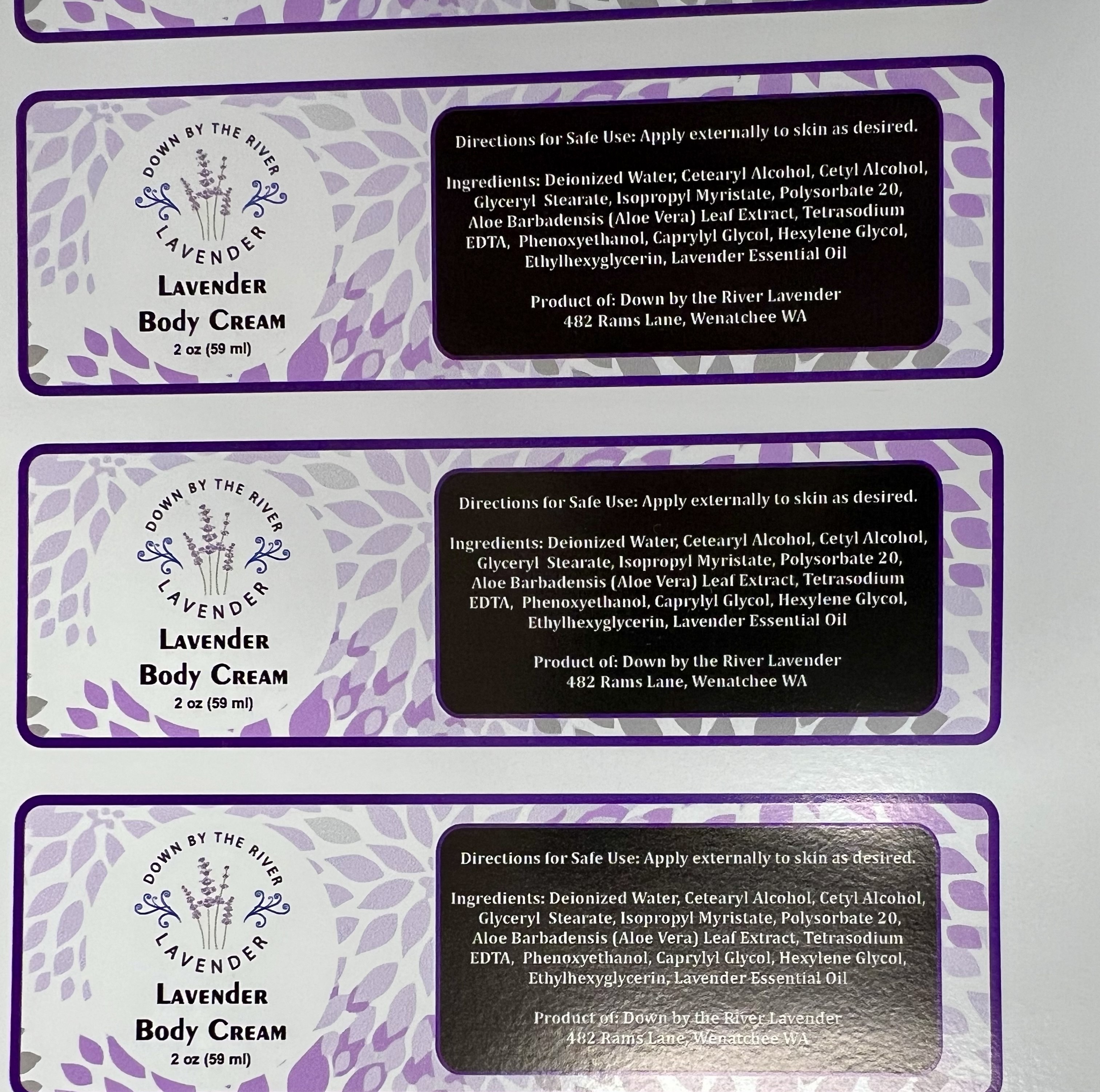

Well don't I feel sheepish now. I thought for sure I'd tried every Roland profile. My rep said that the Roland DGA: Glossy Calendared Vinyl was the best profile, so I didn't question him. In this photo, the top is my original, with the above profile, the bottom is what I just tried with the PCV4 profile. Thank you somecalmtim! This is finally an acceptable decal to sell!
I appreciate everyone's input, and feel pretty lame that it was such a simple fix.
