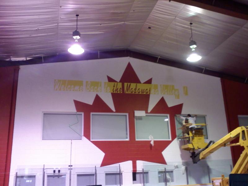

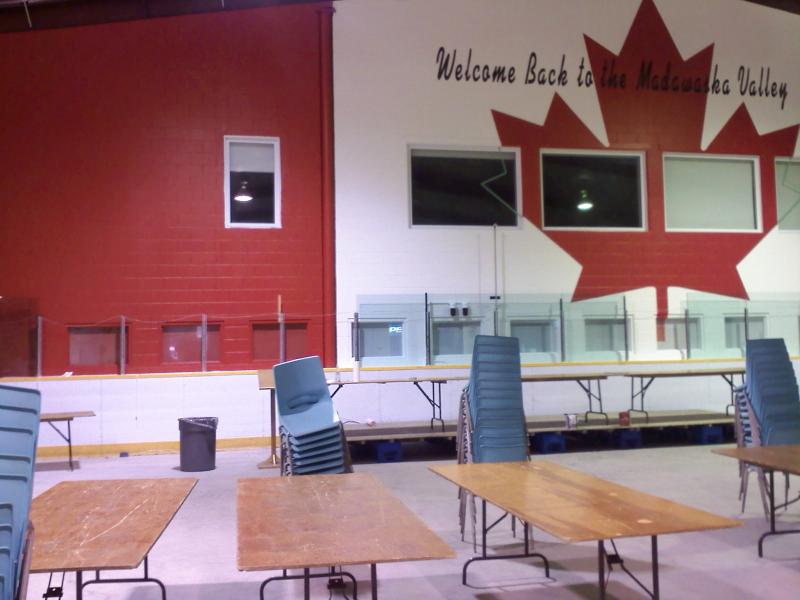

Vinyl as paint mask?
Fitch
+8 Pounce. EXCELLENT money in this job.
Take the plunge and make huge $$$. Someone local at worst can make the pounce and cut in the edges for you. Then all you have to do is paint the "insides".
Just like colouring in.
Cheers
Patrick46
Here's a horse stable that my son & I did in 3 days flat...on CORRIGATED TIN!!! It was about 45' long, and the main lettering was about 3' tall.
Pounce patterns & paint baby!!!!
Pat Whatley
Way too big for paint mask.
Pounce it and paint it. If the letters are that big you won't even need to cut them in with a fitch, you can do the whole thing with rollers.
