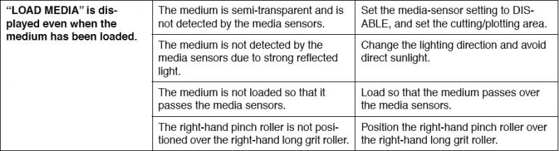

dbenec
ESA1
Checked it out and still no luck. Is it possible that a sensor could be bad?

Bradster941
If the right hand pinch roller is positioned on the long grit roller section, then try putting a piece of tape over the rear sensor and see if that works.
If not, then I think it is a bad rear sensor or bad micro switch on the pinch roller lever.
