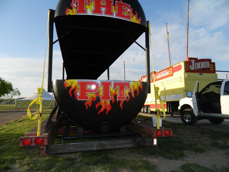

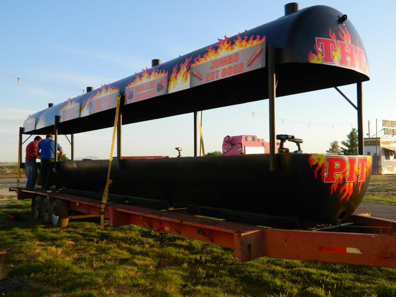

Here is a Giant Grill we did... 1" Plate Steel and 700 degree warm up temps. We Use 480Cv3 and its holding well.
