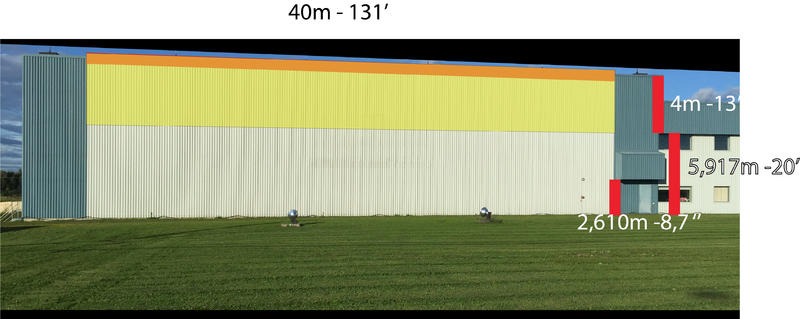

A customer come and want to half facing(yellow part of previous image) of his office building highway front.
I suggest to do this like this:
I plan to do it in 3M-IJ380Cv3 luster.
What did you think about the idea and someone have already do this before ?
Thank's for all replies !

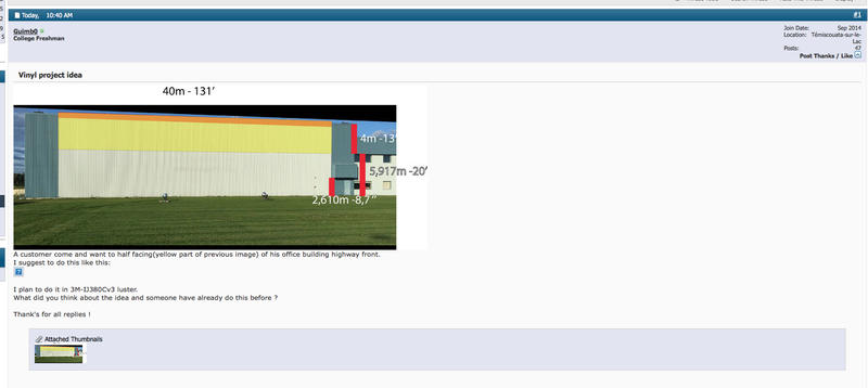

Ok. Makes sense now.
Also attached the reason why I suggested paint from your original post.

letterman7
Wow.. that makes better sense with the addition of the house photo. Personally, I'd probably do ACM panels, print to those, contour cut the house and screw them to the building. You're facing a corrugated metal building with lots of screws or bolts. You'd have to take into account the corrugations in your overall calculations in printing the image (i.e. will be larger than you think), hence printing to a flat surface and attaching would be much easier. Going the banner route would also work properly applied. How long does your customer want it to last?

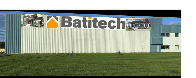

Guimb0
Maybe It's about 5 years or more.
I was thinking on this concept .
Logo and company name hand paint directly on building. (no white background)
In this case witch brand paint do you suggest to me.
And both side printed vinyl to refresh picture after few time .

If you had posted up that concept first, you probably would have received more appropriate responses. I think our first impressions were that a) the yellow part was to be applied and b) the entire side of the building was to have an image.
Since I don't know what is available in Canada in terms of paint, you'll have to research that yourself. Any quality exterior latex or oil will work, depending on your skill level with either. The images.. I'd still put those on flat panels to install. Trying to wrap that around the corrugations and have it look "right" is going to be an issue.
mpn
There is another thread on here about banner spring frames, maybe that'll work if you're changing out the images on the end.

This is right: the entire side of the building was to have an image.
Small images don't look well on big surfaces.
