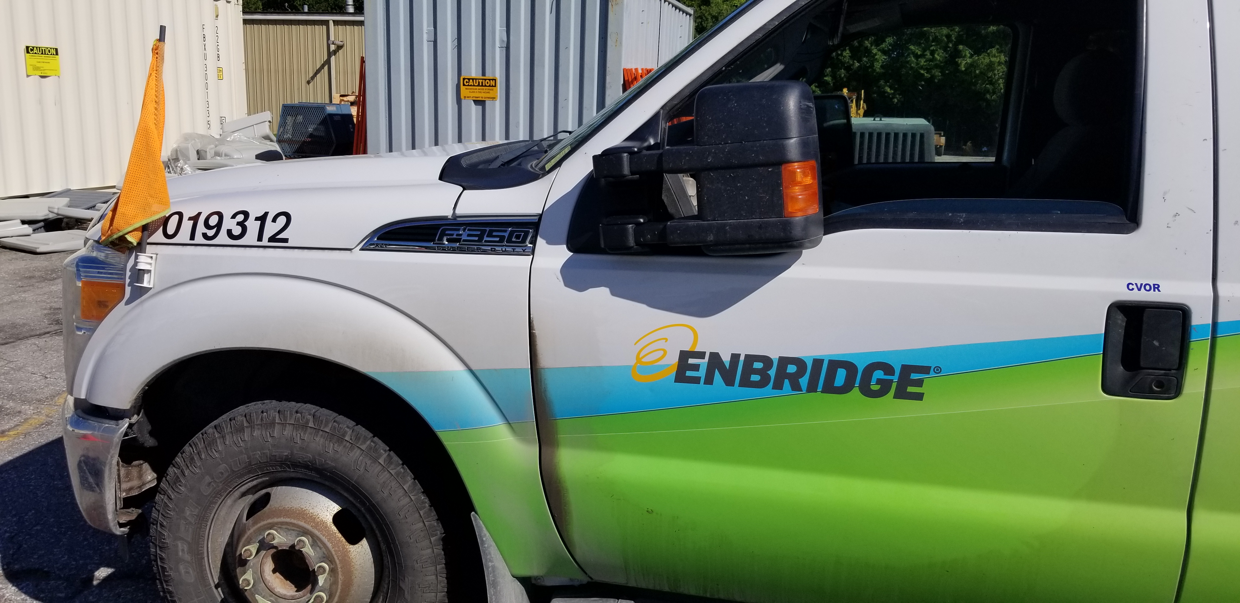

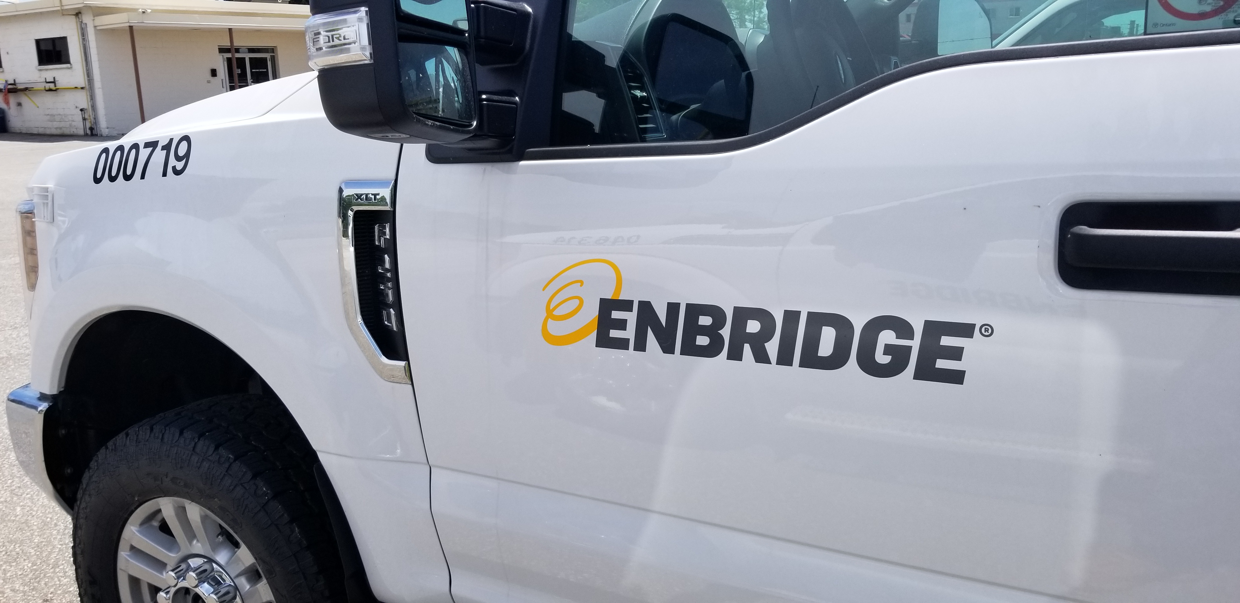

Working in the Sign industry (for 8 different companies)now on my won company, I love Rapid remover, We recently(2019) did removing Union Gas(Reflective vinyl 4-5 years old graphics) vehicle to Enbridge gas rebranding about 280 Vehicles with it, It is the best. Always test first on a small sport. Rapid remover wait 1 - 5 minuets , Clean with paper towel, Clean with Dish soup(Sunlight) and Clean with Isopropyl alcohol ..
