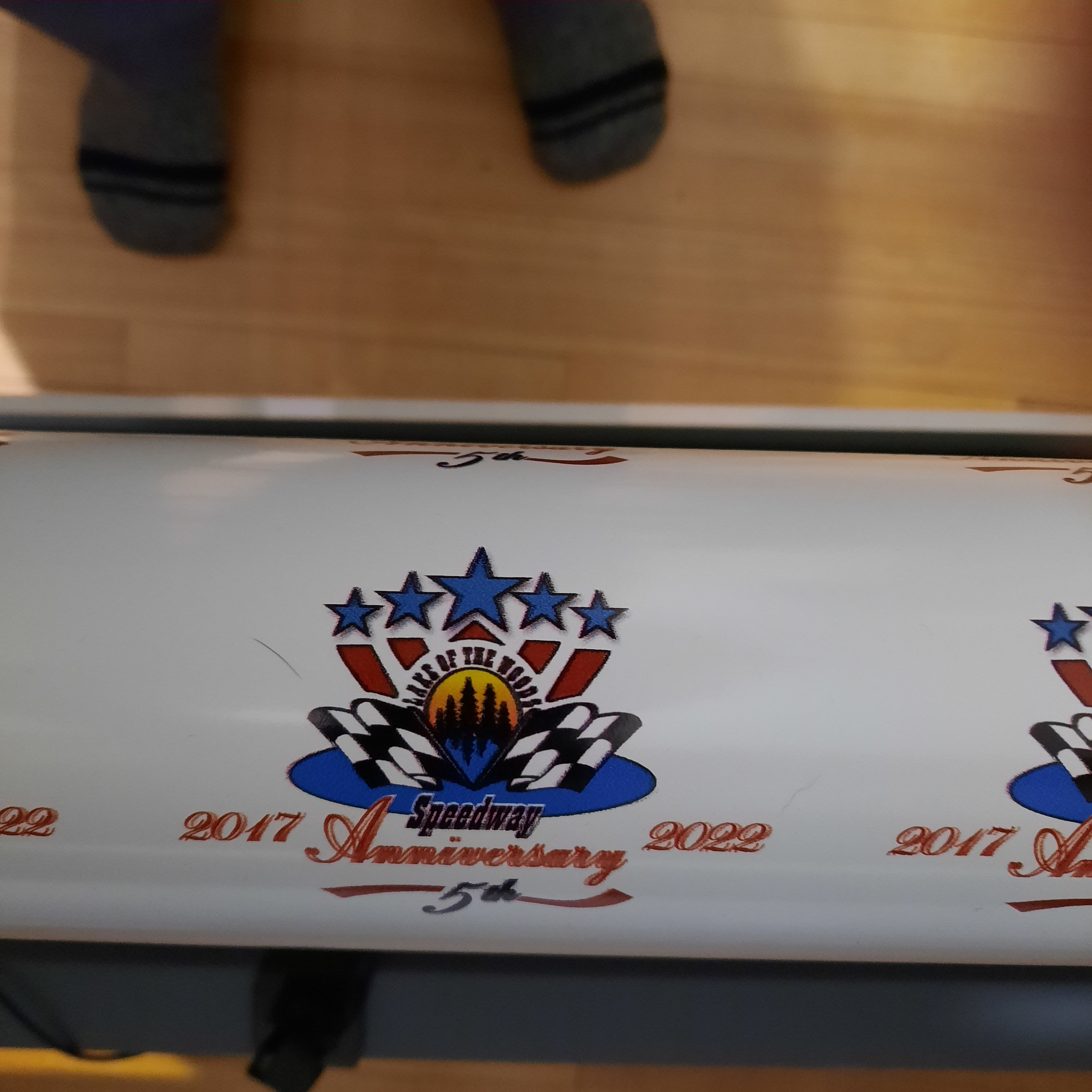

It all started when my prints started getting blurry. I called my local Roland dealer to get their guy to install a new strip and sensor. I have done strips before, but never a sensor. I wanted to see how it was done before I tried it myself. Anyhow, now my printer is shot! The guy did not know what to do and said it was time to start switching out boards. Starting with the Servo board. I texted my old guru, who quit the industry, and he walked me through a few things. When I to the intiialization, it starts at 4000. My 54' printer thinks it is 16 feet long? I put my old parts back in, and it is the same thing. My old guru, who was fantastic, and in the industry for years and years, said he had never seen something like this before. Anyone have any ideas I can try? My printer is old and unsupported by Roland anymore but is / was a great machine. I don't want to lose it.

If no matter what you do it still acts funky during the limit initialization, it's probably the servo board. Post a picture of the blurry prints though. That might give more insight.
