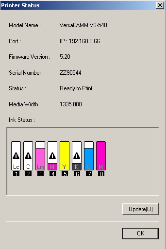

Hi folks, I'm experiencing an issue on my VS-540 for few weeks. As the magenta slowly empty near the "!" level, the printer starts printing REDS as ORANGES so, from there, I figured it's clearly a problem with one of the magentas (CMYK + LC + Lm + CM). I check on the monitor for ink status and it shows a remaining ¼... while the other colors are showing empty for over 2 days and still print fine (w/o beeping yet). 'Made a Medium Cleaning but still got a full track of magenta missing in the print test (that's why it looks more orange than red because of limited magenta saturation into the yellow). To solve the problem I swap the cartridge for a new one. Instantly everything goes back to normal...
Ok, problem solve but what 'bout the remaining 30-35$ of ink in every magenta cartridges??? I'm not only relying on Roland's monitoring, I can feel it when shaking the cartridge (you can feel the wave of ink running top to bottom).
Any clue how to fix it? 'Called my local tech 2X but never got called back after 2 messages. I'm not in a position to waste all that precious liquid at every cartridge. All other colors empty fine 'til the last drop "allowed" except that magenta.

All the hardware (sensors) are running fine according to the fact that the ink level on screen as the one when physically shaking the cartridge are true: there's a ¼ of ink left. The "Doctor House" tech at my Roland dealer says it could be inside the head itself. He's going to make a trip here very soon. I cross my fingers
