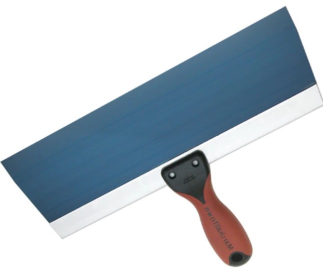

for the wall prepwork - tape a large drywall knife to a broomstick and scrape the entire wall a few times to remove any foreign matter such as roller fuzz, dirt, rocks, dried paint, nail hole domes, etc etc etc. The smoother the wall, the better your graphics will look.
