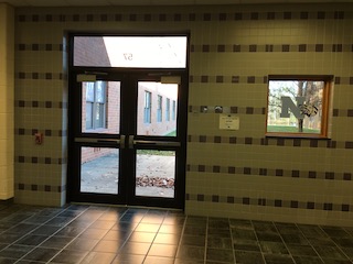

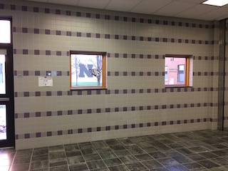

Need to quote installation of a wall mural on this tiled wall - 10' high by 24' wide, lots of windows, doors, indents etc. We have done quite a few textured block walls, but never on tile. How much extra pain am I in for? I think the smooth surface will show every bubble and wrinkle, while the grout lines will tend to pop loose. Need to charge accordingly, or even pass on this one.

I'd think this would be easier than a textured wall, at least as far as post heating every inch. Take a drop of a printed wrap, roll over there and see how it goes down? I'd think tile would be ideal for wrapping, easy to clean and great adhesion, plus built in air channels...

Use a cast vinyl with a cast matte lam. I prefer 3MIj180cv3/8520.
Take a "scrap" panel and go give it a try. This gives you a chance to see what you might need to do on the printed one. Give it a go. All jobs feel a bit scary sometimes. All you can do is mess it up. Then apologize and do it again or give them their money back, and learn from it. Good luck.

We did a bathroom with Dinoc - We were surprised that it stuck to the grout, but after a year it still stayed down and looked perfect.

I'd recommend a thick product like Walk&Wall which you could 'bridge' the grout lines and make the wall look pretty flat/smooth again. It would reduce your installation time by a ton. Low glare surface looks really good as well. If you provide a UPS or FedEx number I can get you a small test roll 24"x10' where you could try it on a section of the wall to see if you like the approach. Just let me know.

How stiff is this walk&wall? And is it meant to be left on longer than 6 months?

IJ180 or 480 or similar products from Avery/Oracal/etc
I’d figure $2000-$2800 installed (depending on your mark ups and labor rate)

I’ve wrapped lots of tile walls that all were fairly easy. As mentioned above, use IJ180 or something similar and bring a rollepro. Post heat after install.

It is essentially a 20oz fabric-backed wall covering with a thick coat of adhesive on it. It will last for as long as you leave it on the wall (assuming it is indoors).
