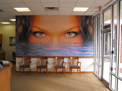

Just got this one up in the lobby for our local pearlevision center. Phototex in 4 panels. Gotta love how easy this product is to install.

We get it from Fellers. Their catalog price for 54"x100' is .84 psf.
If you need it printed I would be happy to provide you with a quote. It's by far one of the easiest products we've used for murals, elevator doors, short term exterior glass, even backlights fairly well. Removal is grab and peel, no residue left behind.

d fleming
Phototex is made for walls. The wall in the pic was your basic flat painted sheetrock wall. It does not curl on the edges, is removable with no residue and fairly easy to install. I've even put it on brick walls with great success as well as glass. It can last a few months outside on glass, brick and stucco and is a good option for short term outdoor window graphics. It has a matte finish.

d fleming
So did you take the picture or have one took ?
Shot it with my digital.
is the water created using a art program or a template ?
did you put it together or was it supplied ?
Customer supplied file @ 2" and 300 dpi, blown, ripped, cropped and chopped to 13" using signlab.
how long did the project take ?
Once the order was in two days.
did you have help ?
1 shoprat for install could have been done with one person but much better and easier with 2.
did use the big squeegee ?
No, don't own one. Can't imagine trying to hit a seam on a wall with it. Looks like a great tool for some things though.
vertical panels ?
Yes.
