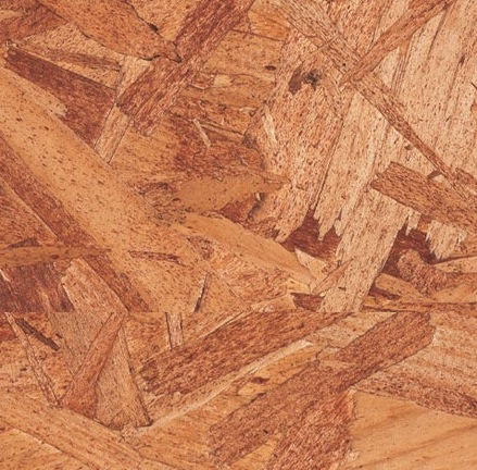

Wafer board = Peg Board ??
If you do paint it, be sure to paint both sides. If only one side is printed, the board will want to warp or bow out.
CS-SignSupply
OSB ? Oriented Strand Board
I hate that garbage ... with moisture in the air it will cause any paint to crack as the wood shifts under the cheap (formaldehyde base) adhesive. your best bet would have been when it was off to seal the back completely with an oil based sealer then using an automotive primer to do multiple paint and sand jobs before applying a surface coat.
+1 to the idea of using standard vinyl as I would give it a year before that surface looks like garbage and or has peeling vinyl.
Inform the customer of this as well. ... if they need a fix, masonite can be applied to the surface with a laminate adhesive and brads then painted with a good oil based primer and glossy paint which will last a LOONNNGGG time and give good results.
