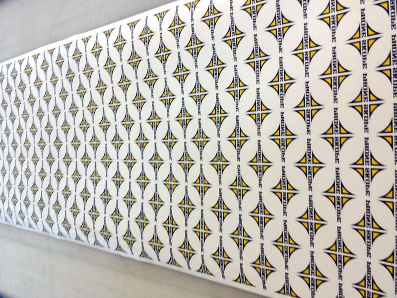

Hydrographic Film printing
Do you know of a supplier of this media? I was looking into this 3 yrs ago and decided against since I coulnd't print custom patterns. Seemed like that is what everyone wanted. Thanks!
Sure! We print custom Hydrographic film here in house. Not a problem! Just PM me and we'll get the ball rolling.
attachment.php
