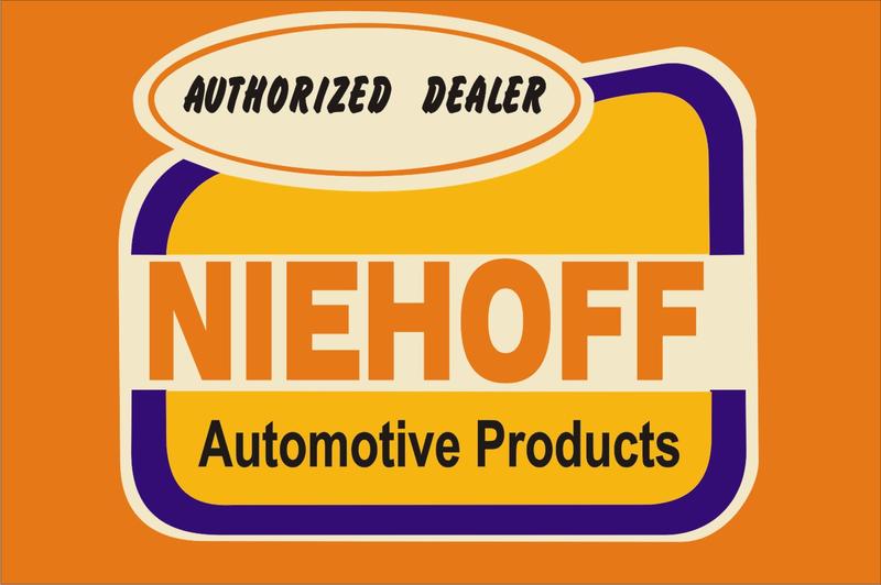

i did a neihoff logo(automotive ignition parts)and it had a white area. since it was a restore project i "yellowed" the white..........part so it looks old instead of a stark white. made the water slide and it went on an orange cabinet.

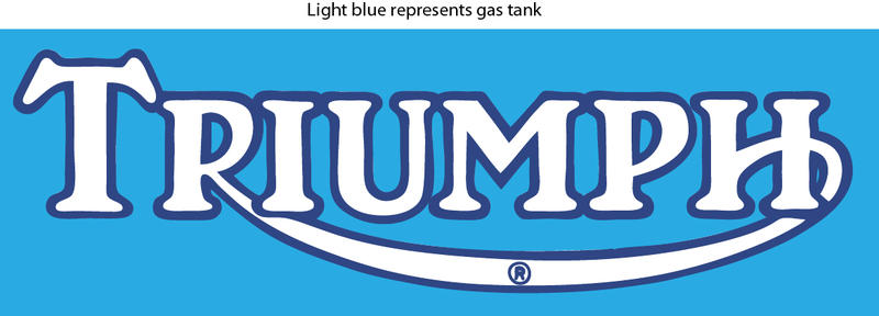

How many and what size? I have white water slide media and can print blue on it. Would that work or is clear part of the design?

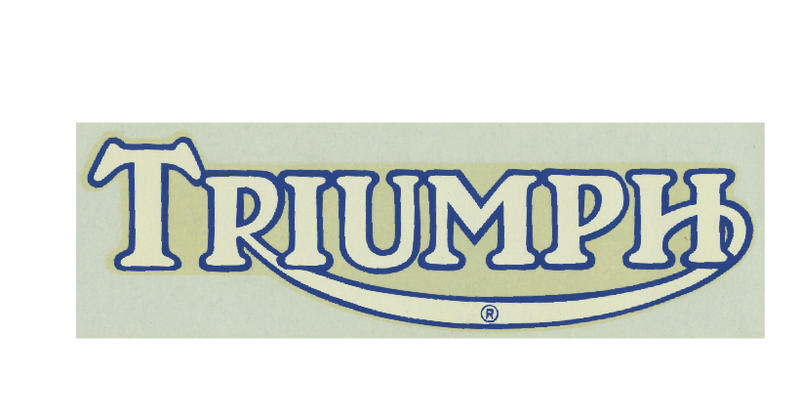

mpn
Clear is needed to match the original.

OldPaint
clear is for the background ONLY??? text would be WHITE LETTERS BLUE OUTLINED? so where is your problem?? like i said in my earlier post.......about the neihoff logo. only reason i did the water slide .....as its was what was ORIGINALLY DONE... i gather the rectangle is the water slide.......ok..........getting the text with a blue outline is eazy on a regular printer.....instead of using pure white as the TRIUMPH word go to your color pick a light blue..........for the fill(what you want as white)take it as far as you can to a WHITE......with a slight blue "tint". DONE
mpn
I understand how to print it. My problem is recreating an exact waterslide decal not a vinyl recreation. It's hard to see the variation between the actual decal and the backer but it's there.
Apparently this is the only version of this exact decal left.

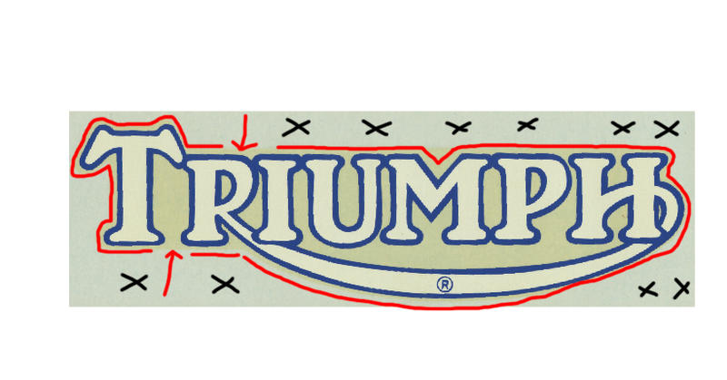

OldPaint
to get that.....as per #1 picture.......with a little of the waterslide all the way around... after you produce the printed on water slide AND CLEAR COAT with krylon clear, let it dry and then YOU will have to use an exacto knife and cut that outside RED line.

Old Paint, we do not have the correct printers for printing on the waterside material, unless I'm missing the eco solvent printable material. Clearing & cutting is not the problem. I'm leaning towards screen printing them here if I have to.
