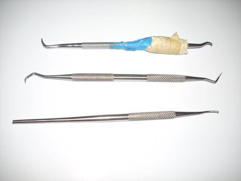

Just wondering what others use for weeding vinyl.
This is what I use. The top one is 6 years old.

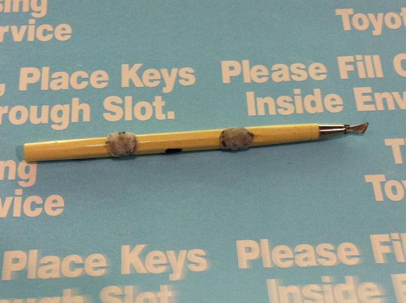

I Use the Ulano stripping tool that came with my Gerber 4b. I have had the thing for over 20 years and they dont make them anymore. I can weed quite fast with it and man is there a panic when i cant find it.
I had one of those but lost it. I still miss it

gabagoo
I love it and unlike an exacto you can use the flat blade to either pick the centres out or sometimes what i do on certain sizes is I slide the blade and it sort of scoops it out with no damage to the silicone paper.
I wish I knew why they discontinued these but I have a feeling they were origianlly designed for use with rubylith and that answers that question lol :(
