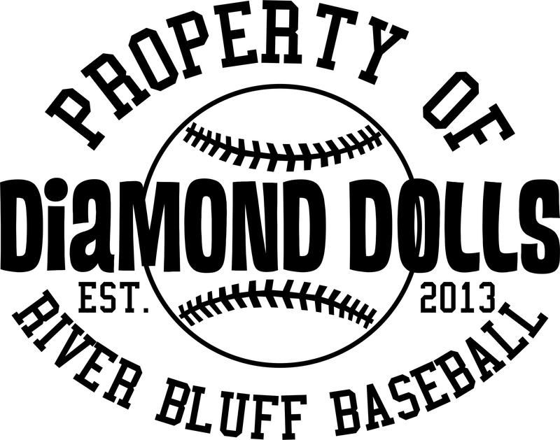

I have the attached logo that I need to vinyl cut. I need to "weld" the baseball to the word "Diamond Dolls" so that I want have little segments where the two items intersect. I can't figure out how to weld it. When I do, I lose insides of things. What do I need to do? I am going to save the solution on this because I have had this come up a few times and just said "screw it" and have little segment pieces. But I need to learn how to do this.

are the white pieces of the ball still there? if so do a back minus front on them then delete. then just select areas you want welded and click weld.

The ball currently it two circles on top of each other. The larger is filled with black and the inner is filled with white. The stitches are on top of the white circle filled in black and are separate. I can take the fills out if I need and just change the circles to outlines.
WildWestDesigns
If the black and white circles are pure circles. Minus front, so the white is then transparent and then weld those letters that touch the baseball.
If I'm understanding the situation correctly.
bob
Assuming the "Diamond Dolls' is a single object, either text or vector, and the baseball outline is also an object merely select them both and then do Arrange->Shaping->Weld. At least the complete ball outline, the 'M', and the 'O' must be objects, the 'O' consisting of two vectors, and they all must be closed paths, in order to weld them.
If the baseball outline is an outline then you'll need to convert that outline to an object before you attempt to weld the two objects. Select the outlined object and then do Arrange->Convert Outline To Object.
LUV DEM TIGERS
That got me closer. I did the back minus front. Then I converted the text to curves, broke the curve apart, and welded the "M" to the ball and it worked great. When I did welded the outside of the "O" or the inside part of the "O" to the ball, it made the inside segment of the ball disappear that was inside the middle of the "O".

That got me closer. I did the minus front. Then I converted the text to curves, broke the curve apart, and welded the "M" to the ball and it worked great. When I did welded the outside of the "O" or the inside part of the "O" to the ball, it made the inside segment of the ball disappear that was inside the middle of the "O".

I did everything up to and including the "M" being welded and everything looked great up to that point. Then with the "O" I think I have tried ever combination possible. I grouped both parts of the "O" and didn't get the right result after welding. I then tried welding just the outside of the "O" still not the right result and then tried welding just the inside of the "O" and still not the right result.

Select both the inner and out parts of the 'O' and combine them into a single object. Then weld this object to the ball.
Winner, Winner, Chicken Dinner. That was what I needed to do. Thanks so much. Now I will make myself a cheat sheet on how to do this for the future. Thanks for everyone's help.
