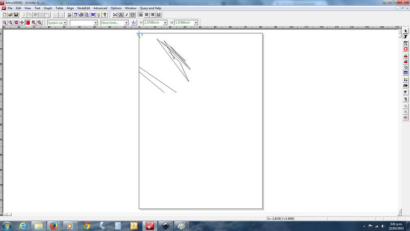

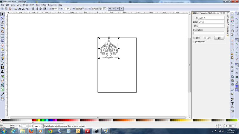

BUT, here's my problem, artcut opens the *eps and it shows up like this (first pic' is in Inkscape & vectorized, 2nd is how artcut opens it.

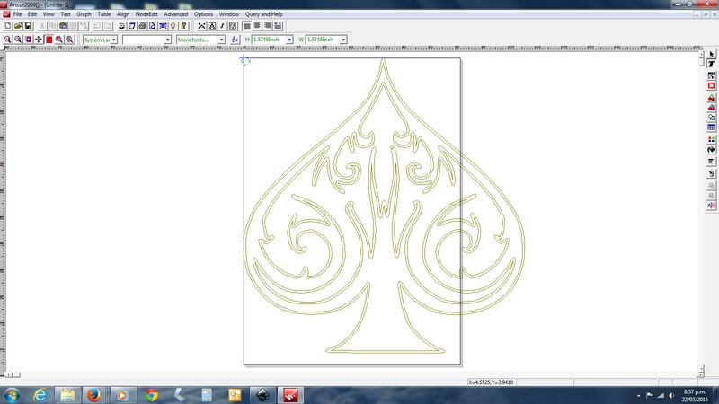

Can get from Inkscape to artcut as dxf but once there it's WAAAAY to big and is un-editable for some reason.
Pic' in artcut as dxf.

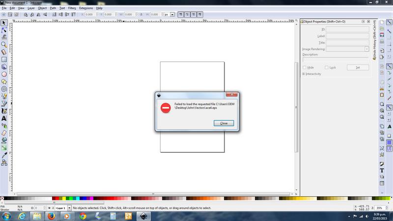

HMMMMM........................Inkscape will save it as an *eps but won't open it as an *eps.

From my limited Inkscape experience, I don't think inkscape will 'open' an EPS file. Try saving the inkscape file as eps, then import the eps file into artcut. Might work?

The one thing that you have to be aware of with Inkscape is that even if you save as an EPS, it does do a bitmap clipping mask as well, which defeats the purpose of plotter use. In order to get rid of that clipping mask and have it usable is to open it up in Ai (or DRAW) and remove it and you are off to the races. I do not seem to recall a fix in the beta version of .9 either, but it's been awhile since I've played with that.
