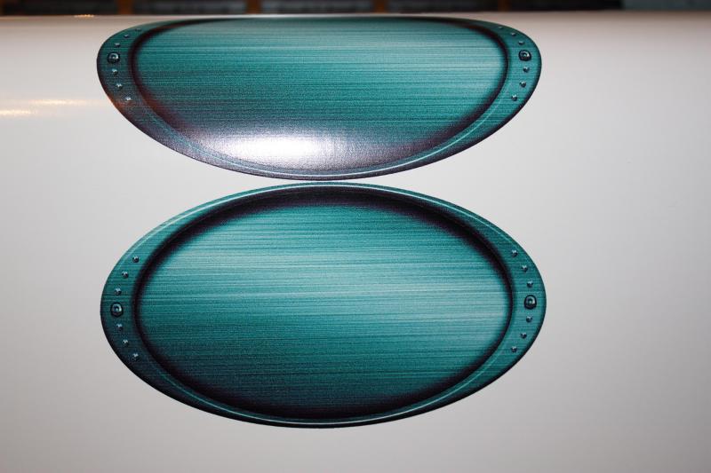

Hi all! I am going out of my mind. I am not sure what happened but for some reason my colors in any Image file have gone crazy. All my cmyk RGB or any vector colors are right on. If i print a jpg or anything out of photoshop (mostly in the grays) the print is green??!! I have played with everything I can think of.. I have flexi 8.5 and a prismjet. I also have a valujet.. same files print great... Please help!
The image was brushed silver alum

fixed it... I do not understand it at all... I ran out of LM & LC ... printer did not warn me! once I replaced them both and sucked some ink in, everything started working just fine!!! thanks for the advice guys!!
