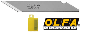

I have an XC-540mt and its no longer cross cutting things deep enough. I've never changed the blade so I think its time for that. Can anyone provide me of a picture of the blade so I can confirm that this pile of blades on my desk is what is actually needed. Any kind of tutorial or walk through would be great as well.

Are you referring to the sheet cut blade? If so, it should look as follows:
attachment.php
To change it you simply need to unscrew a small knob on the front of the sheet cut mechanism (to the left of the cut carriage) and slide the blade upwards and remove. Stick the new blade to the small magnet and slide the blade back down in the slot and tighten the knob up again.
