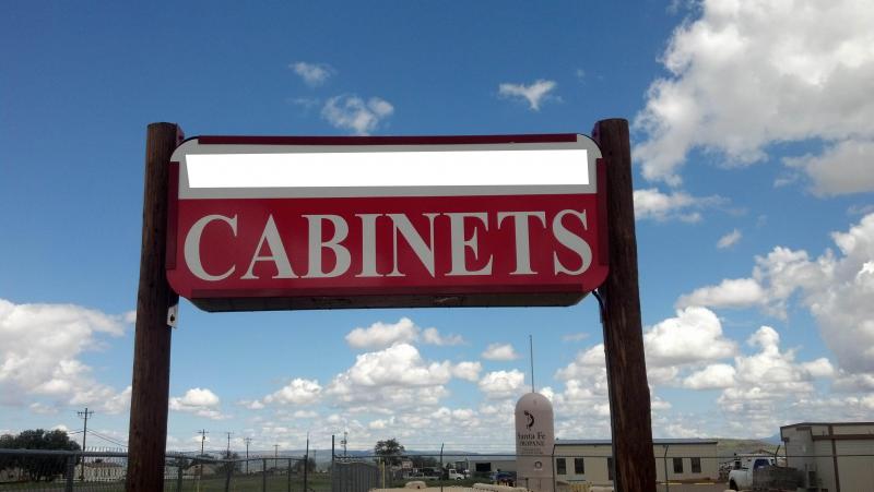

Having a little trouble with the customer over this sign. Please give your opinion as to what is wrong with this sign.

Kerning is way off, no corner as stated above, and, its missing something on top, I dont know, just something. :banghead:
Ah, nvermnd, its the White Box Ca bin et Store.
They sell cabinets intermittently.
300mphGraphics
I was hoping for a few more responses.. Customer says sign doesn't fit, I say it is correct for when the corner pieces are put back on. He wants the sign faces to go over the corners. I explained how a sign works with the retainers going all the way around. Customer says he doesn't have them and they were not there when he bought the property. He thinks the new faces should match up to the can corners. Customer took all the retaining pieces off and repainted everything with only the can being there when I surveyed. I went back to dry fit the face and he had the straight pieces on but not the corners, which made it easy to trace a template of the corner radii.
Bottom line, in my opinion, is the sign needs the corner retaining pieces and the problem is solved. It's an old can that has settled and is not perfectly square. Is the best solution to have corners made up by the local sheet metal shop?

You may not need to go to a metal shop.
I would kerf cut some angle (for a retainer)
the shape of the radius corner...
Then to hide the cuts, slap some aluminum
the shape if the retainer face, then paint to match.

It's mounted between railway ties?
They're actually utility/telephone poles and have been there for years with everything settled into place. The can is half inch out of square, which is another reason I explained to him the face needs room to float some. That, plus, as J Hill said, expansion and contraction and being able to slide it into place to begin with.
Yes, difficult customer but the sign is in place and working and the deposit and final bill paid. If we can purchase or make new corner pieces, hopefully everyone is happy. :smile:
