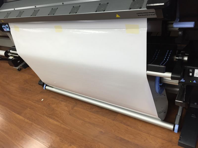

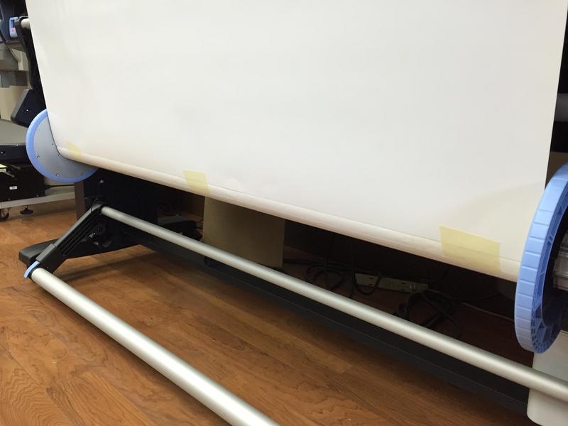

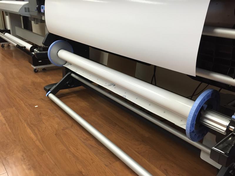

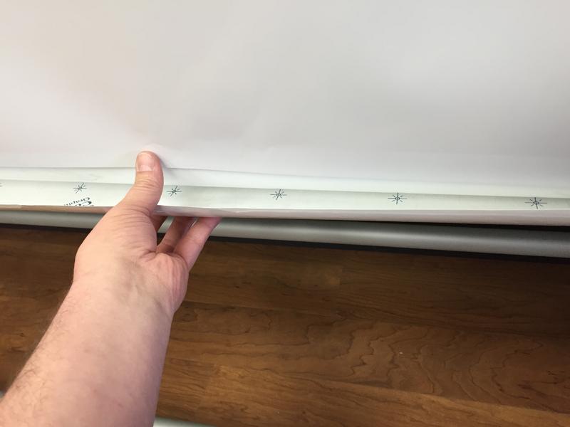

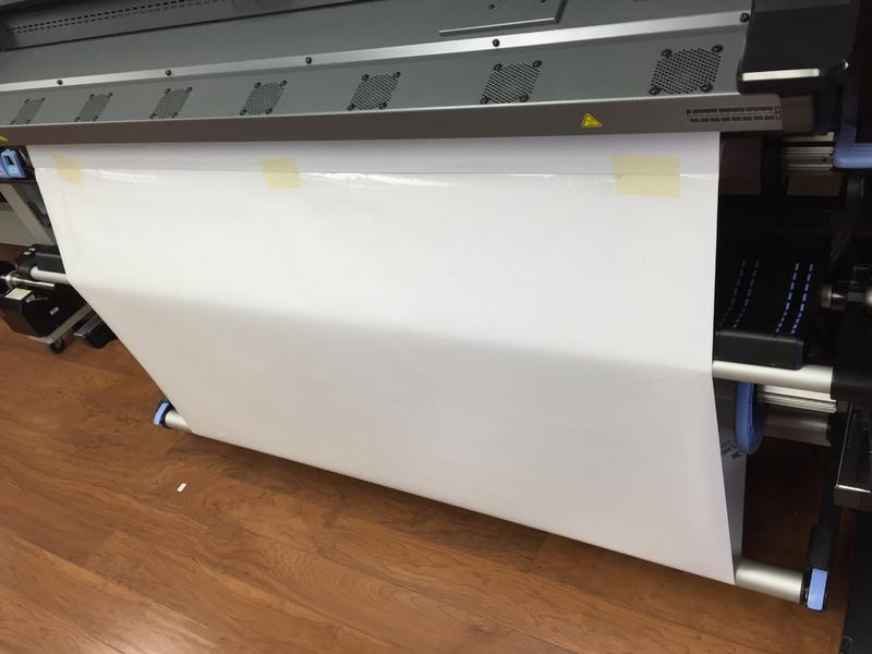

So I have a way that is different from everyone here.
I have a 54" roll of vinyl media with about 8 feet still attached to the core.
I load the roll on the take up and it stays there. Always.
Next I load up 54" material that I want to print on like normal. then I will run out the material all the way down to the take up reel. Then I tape my media to the vinyl on the take up reel together. At this point I push the button that starts unloading the takeup reel while at the same time i start back rolling the media in the printer. I stop it when my seam gets right to the opening of the curing area. I run the take up roll a bit more to get slack in the loop. then i put in the the bar and then roll it back up until its taunt.
The idea is that instead of leaving 3ish feet wasted. I just have the printer back roll it. There is still a little waste but only about 12-18 inches.

Davo
Looks like a bit of waste to me, then again, you can never print on the final metre or so of media anyway!
dypinc
That is an excellent idea. Makes me rethink how I load fabric. Might have to use straight pins instead of tape but it should keep the fabric tight without having to waste so much.
