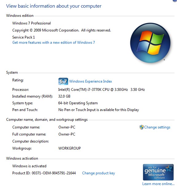

The attached image shows the specs on our design computer. We purchased it four years ago and it's been a solid performer ever since. We spent over $2,000 for it and didn't even bat an eyelash.
That would be around $1,500
With the time it saves, it will pay itself off the first year.
i7
32 gigs ram
Solid state C drive
2nd 2 to 5 gig data drive
Healthy graphics card
This is exactly what we have. The solid state drive gets things done so incredibly fast.
If that was a 4.0 Ghz processor, that thing would haul butt

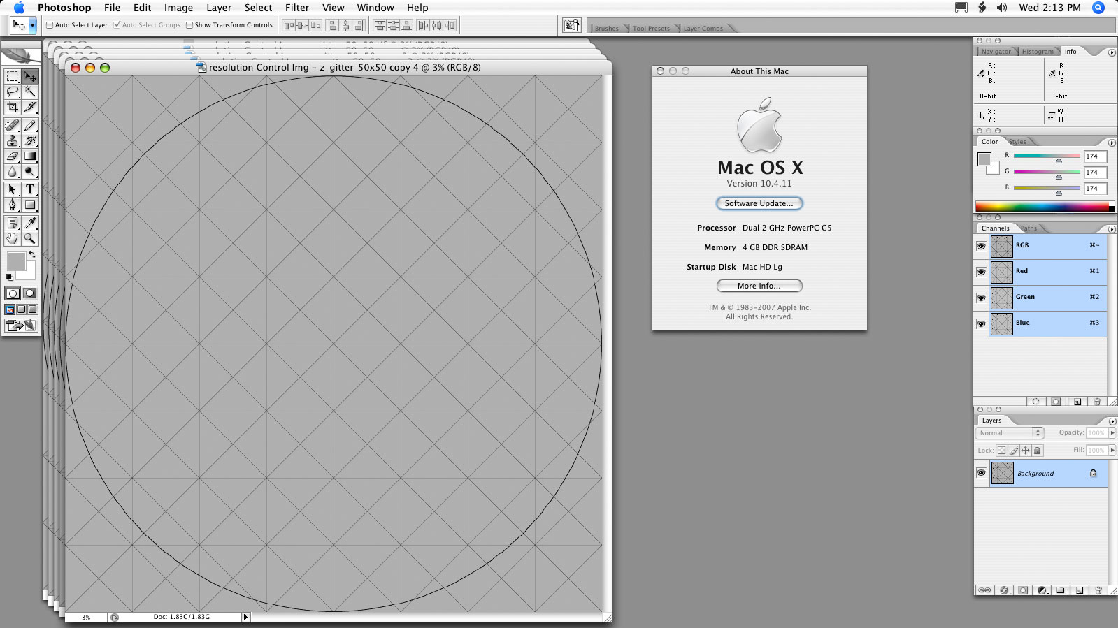

Don’t forget the specs for the all-important scratch disk, also known as page disk, required by most image editing software and RIPs.
As a point of reference, see the screen shot below made today of a 15 year old pre-Intel Mac with only 4G RAM total. Open are 5 files of 1.8G each totaling 9G of Photoshop CS2 files. Notice open, but totaling more than the machine has RAM.
Photoshop will use RAM as available but will always page file to disk as part of its normal process. Of course RAM is important as some operations in PS and other software can only operate in RAM such as certain filters, etc. The old rule of thumb for Photoshop was 4 times the scratch disk for your open file(s). RIPs don’t really require a lot of RAM but do require a lot of page space.
It still haul's a$$. I've been very happy with it since day one. Then I go home at night and work on my home PC and I just want to throw it through the window. Fortunately, at home I have dual monitors so that saves me a bit of time, but my processor at home is SLOOOOW. But that's what you get when you spend $600 on a touch screen PC at "Worst Buy".
