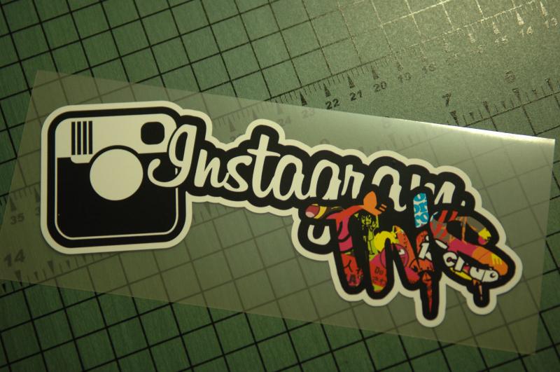

What kind of vinyl is this? (printable - clear backing)

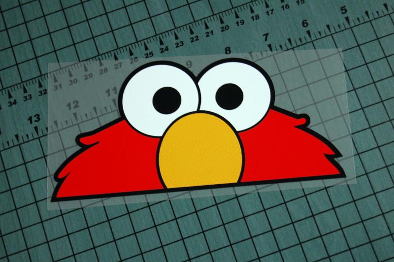

What kind of vinyl do you think this is?
attachment.php
attachment.php

Turfa
Ij8150 ?
If the vinyl is clear & the print uses white ink it could be 3M IJ8150. That's a 2mil optically clear cast film that is printable & comes on a clear plastic liner.
J Hill Designs
I would also say 3m electrocut (7725)
any vinyl is printable IMO, most just isn't 'QC'd' for digi printing (read: you need to clean it)
Jackpine
JHill....any vinyl is printable IMO
I've printed on colored cut vinyl for effects. Wipe the vinly with 90% denatured alcohol and print.
