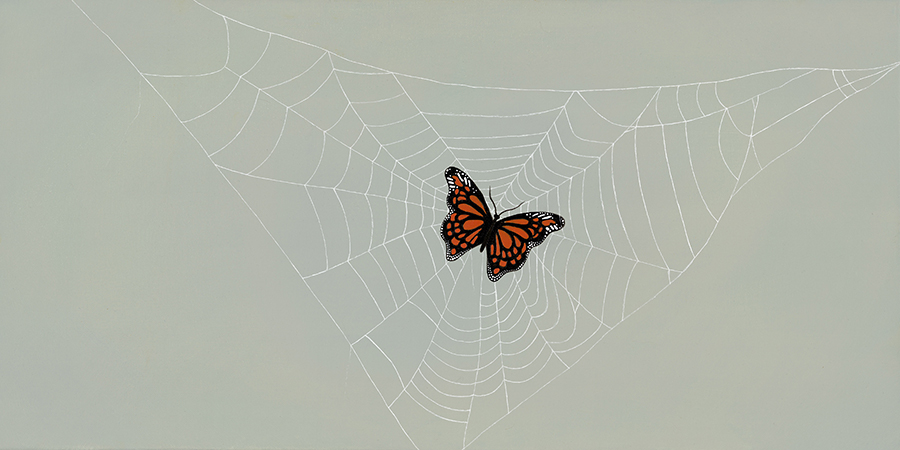

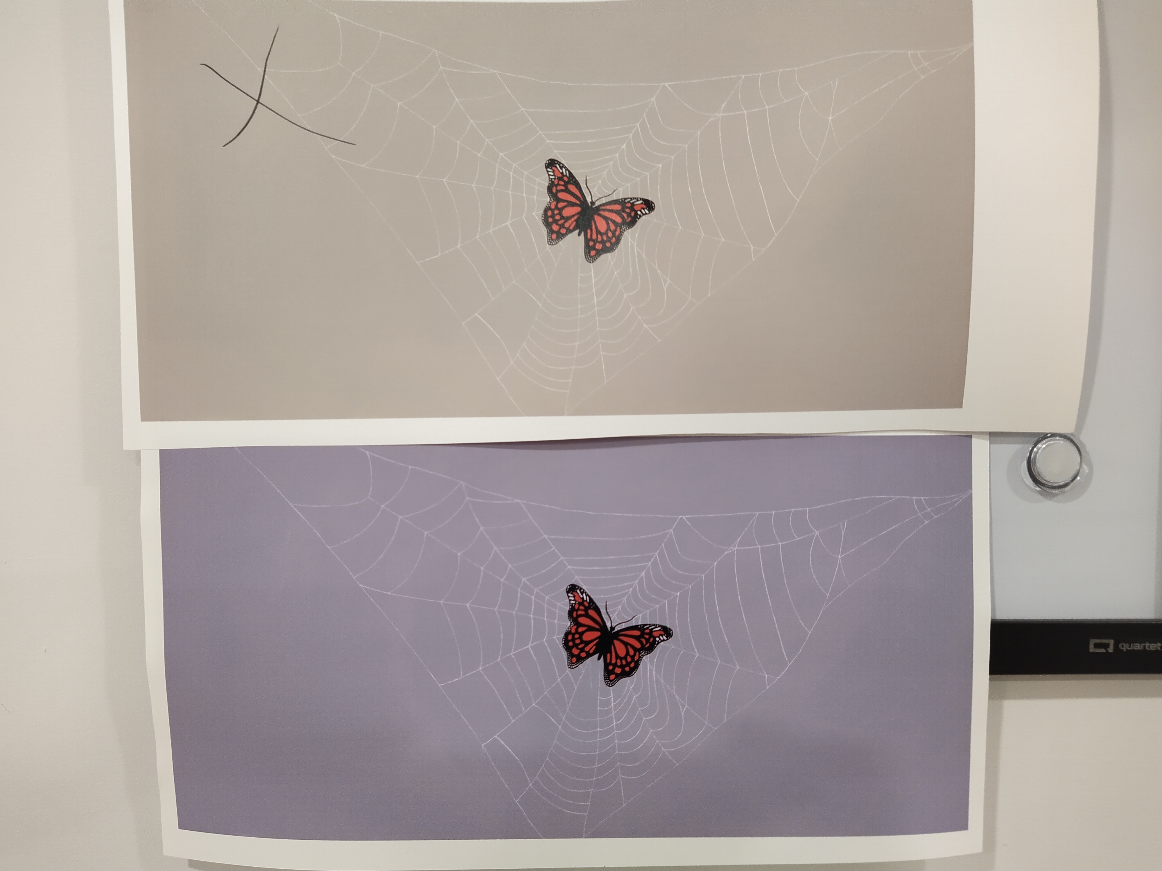

I know the screen and the actual output will never be 100% in my world but this is brutal.
The first image is a thumbnail where the background is a flat greygreeny colour. The second is after a calibration thinking something may be off. Blech, not much better as greygreeny turns to purpley.
I've been very lucky so far but I have to figure how to step up my game.

HP 365 using Flexi HP 212
Everything today is coming out pinkish.
So, this is all on the heals of the subscription renewal. For the past year more or less everything has been printed with colour correction. Now without colour correction it seems to be back to where it needs to be.
I even went through the calibration twice and the second calibration actually comes in more pink.

About three weeks ago I replaced all of the printheads and inks including the optimizer, and I gave the machine a once over and called it nice things. From there I completed updated calibrations on a few popular media.
All seemed good until the software renewal on Wednesday and everything went to pinkish and purplish. Again I re-calibrated again and completed a control print and all looks good.
If I print with colour correction, which was the best option for the last year, everything was pretty close to were it had to be. Now I get the results I want with no colour correction.
The only thing that changed to start this debacle was the software renewal (I think).
