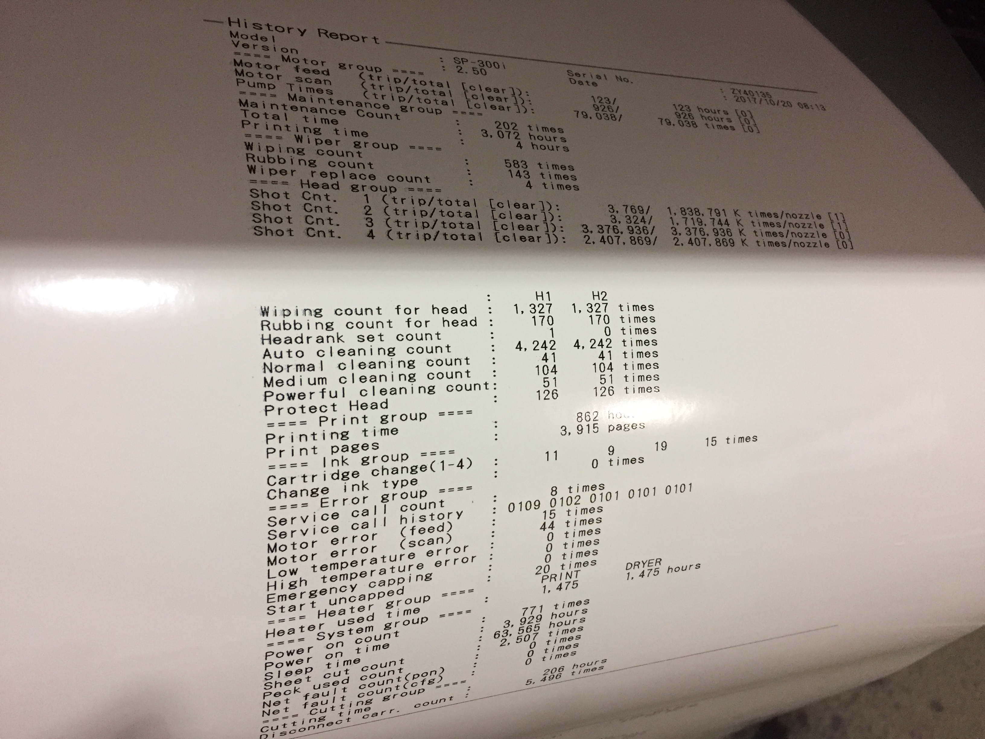

Have them print the system report and send it to you. This will give you more of an idea of the use of the machine. Specifically you want to look at the nozzle fires of each head. 6 billion is considered end of life for these heads. The closer they are to that number, the more likely you will need to change one in the near future. The SP300i series is not super old so as long as everything is working properly, head life is really all you need to worry about. Motors almost never go bad. You just want to make sure it is clean and everything is working properly. I don't have a lot of statistics on how long the average machine lasts but 3000 hours would be about 2-3 years of use in a small shop. I see these machines running anywhere from 5 - 10 years with proper upkeep.
Solventinkjet
DIY Printer Fixing Guide
So the printer has only actually printed for 862 hours which is better than you thought. The first print head, which I believe is the Cyan/Black head, has been changed recently and only has about 3.3 million fires per channel. So it's basically brand new. The 2nd head which is the yellow/magenta head is older and has about 2.4 - 3.3 billion fires which is about half the life span of these heads. Still pretty good for a used machine. It looks like at some point they were having issues with the scan motor system which is why there are 44 scan motor errors. This was most likely a bad encoder strip or sensor as the motor was never changed and motors almost never go bad in my experience. Looks like the machine is in good condition on paper. I would definitely go check it out in person to make sure it isn't making a bunch of weird noises or just looks really dirty.
I forgot to mention, the machine is a little over 7 years old based on the sleep time. So in 7 years the owner only printed with it for a total of about 36 days. This machine is old but barely used. The fact that they had to change the 1st head at about 2 billion fires tells me this machine basically sat around not being used every day and the head dried out. It should be a good buy if the price is right.
Dealer got back said motor scan errors were result of a pinch roller, said once it was aligned no more issues. Does that make sense to anyone?
