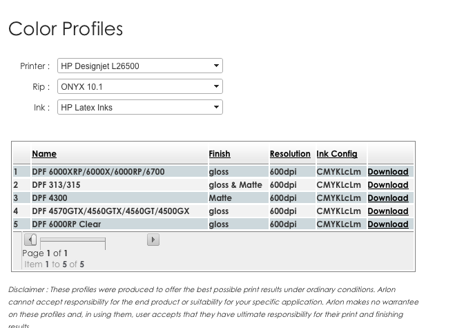

I believe you have the HP latex right? If so what profile do you use to print on Arlon?
MikePro
used IJ180cv3 profile off the bat, no color issues, but then eventually made my own profile via Onyx/HP26500.
i think arlon has stock profiles now via their website tho'.
edited: yup, 26500 profiles for Arlon materials, as well as other printer/rip combos, have been added to their website
