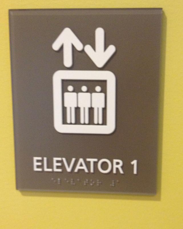

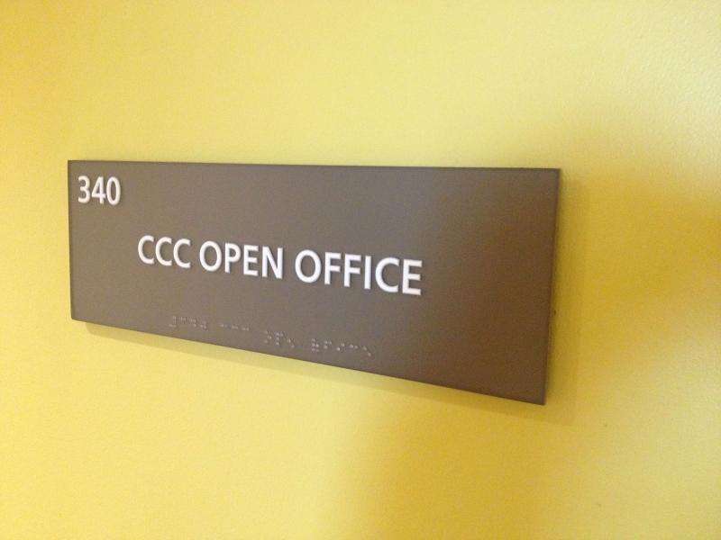

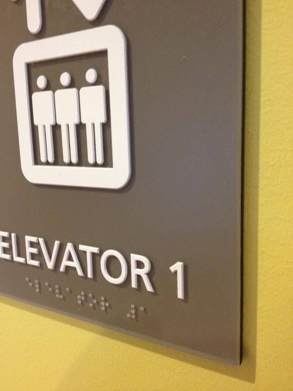

Does anyone know the vendor on this specific ADA Signage? I need to add in some signs, but do not know where they were originally obtained. It looks like it was a sandwich of clear and white acrylic, and the white was routered away except for the letters. Don't know how the braille was done, perhaps after the surface was routered. The back was then painted and mated with black.

The lettering is cut from Rowmark material using a rotary engraver, placed on some reverse painted acrylic. the braille is done using the raster method. contact Accent Sign Systems and find the closest licenced raster shop near you, these are pretty basic.
